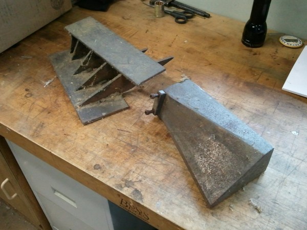

Here is a photo of the forms I used to make the blades. The one on the left is the quick & dirty form I used for the experimental steel blades. The one on the right is the cast iron form I had cast to give a smoother shape to the brass blades. I started with 3/8" thick brass, band sawed to shape, and shaped with a hand grinder into the proper profile for a blade. The blade blanks needed to be heated with a torch,and hammered while still hot to take on the needed twist. The still roughly rectangular stubs on inside end of each blade were then silver soldered into corresponding slots milled into the hub.
