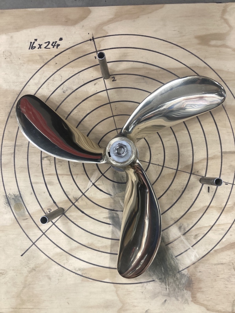

Posts: 266
Re: Steam Thistle Cluaran
After many working hours over the past month, I finally finished the new rough sand-cast bronze 16" diameter x 24 pitch steamboat propeller,
sold to me by Pat Spurlock of Elliott Bay Steam Launch Co, in Portland, Oregon, USA!
It's now a Tylenol afternoon for my shoulders.
Pics attached (of the prop, not my shoulders...)
Next is to make boat performance tests of the old prop, and then repeat for the new prop. 'Should be fun.
Posts: 576
Hi Russ
That looks wonderful. I would never have thought of putting chrome plating on it, but it looks fabulous.
It will be interesting to see your performance data so good luck with the tests. I am intrigued by what one would need to do. No doubt it will be ingenious. I am still surprised that I was able to weigh Frances Anne with bathroom scales after advice from this Forum, so I am anticipating something equally amazing.
