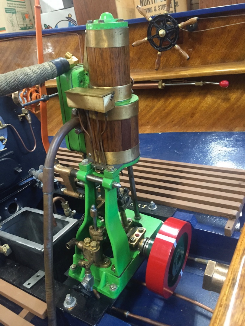

I built a Blackstaffe steeple from a casting kit I bought from Cliff Blackstaffe's son. Since then, I understand that the son had died, and the family threw out all of Cliff's patterns. As a result, I am in possession of the blueprints, and if you send me your email address, I can email a set to you.

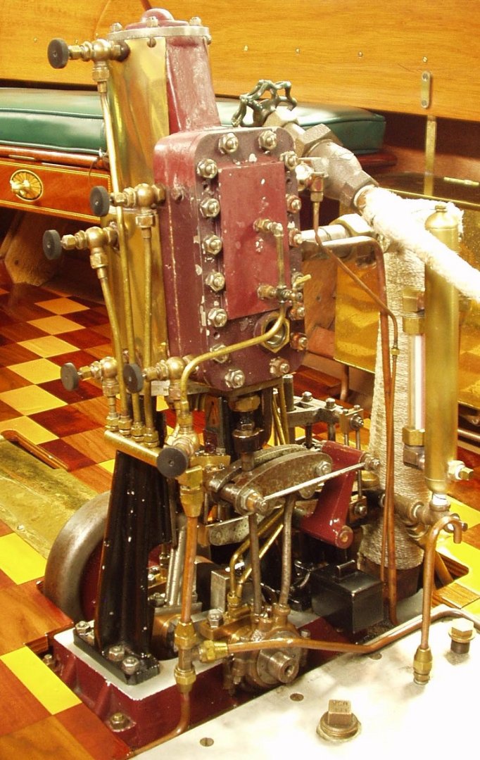

I have an original 1960s Blackstaff steeple compound engine in my steamer.
I also got with it a set of photo copied partial(?) drawings.
If you are missing some I can compare with you and see if I have additional useful drawings.

Hi Russ,
I'd be curious to learn what changepoints were made from the original 1960's version to Kelly's later version. I can already see some slight changes to the frame/crosshead between the two images above. If you and Kelly don't mind, I might lean on y'all for advise/questions.

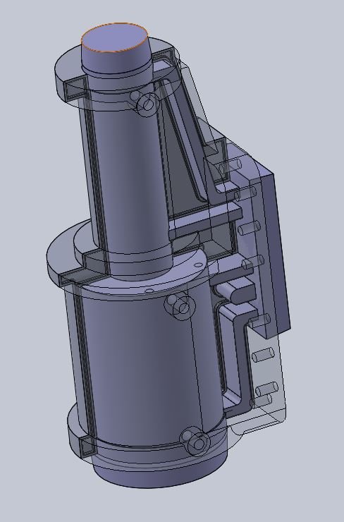

Update:
Below is a model that I put together to test out the core features. Since I want to try to make as much of the castings in the investment foundry, I need to verify that I can assemble the 3D print (wax infused PLA) overtop of the core. If assembly works, then I'll need to make or procure a ceramic core (conventional sand cores do not work well in the investment cast process).
Test Cylinder and Core Model.JPG (44.46 KiB) Viewed 173516 times
Posts: 865
Re: Blackstaff Steeple Compound Drawings/Information
You should be able to get very funs results with investment casting. Are you aiming to do it in iron?
What will you do for the partition between the bottom of the HP and top of the LP cylinder?

Hi Wesley,
We might try silicone bronze for the cylinder.
The cylinder will be cast as one piece, it looks like Cliff designed the engine to have a separate piece installed to it that acts as the partition between hp and lp.
