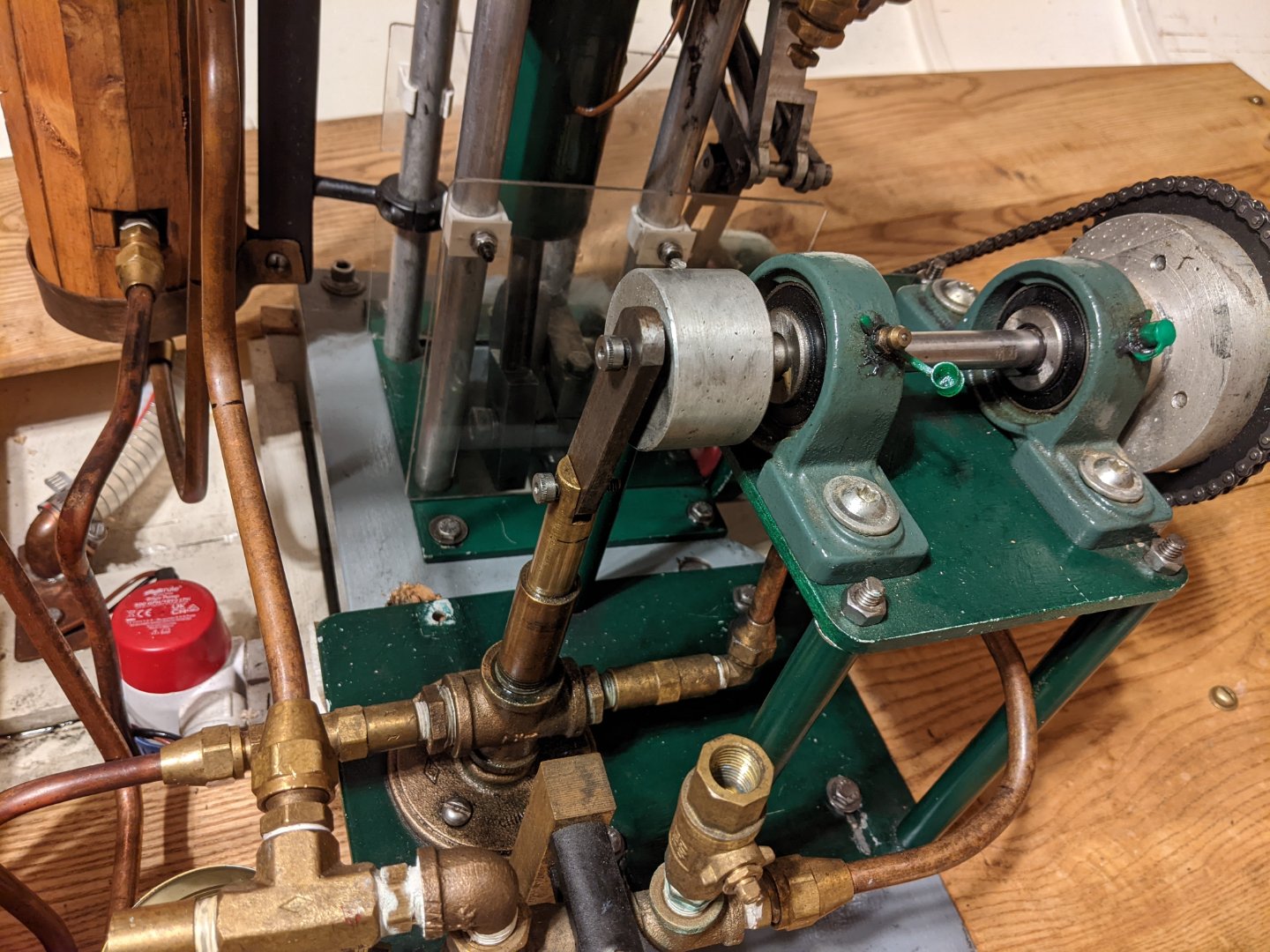

Post by Peter H »
My engine is 2 1/4 by 3 and runs at 100psi max. My pump is single acting and is 5/8 bore with a 1 1/4 stroke. The pump runs at 1/4 engine speed.
