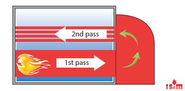

Another variant of the firetube boiler is the locomotive (or Gunboat) type of boiler. Technically very similar to the VFT with a firebox, they perform similarly, with the advantage of a lower center of gravity, but a somewhat more difficult build process. Another practical firetube boiler is the Scotch Marine boiler, where the tube pass is a 180 degree reversal of the flue gas passage, as opposed to the loco boiler’s straight thru one direction flue gas flow path. While several of these boiler types are found on UK steamboats, I have not seen them used in the USA steamboats, with only rare exceptions.

Another traditional fire tube steam boat boiler is the Scotch boiler; in small boats these are typically dry-back.
These are more compact than the loco or gunboat designs, and don't require stays for the same reason that a vertical fire tube boiler does not - the tubes act as stays.
