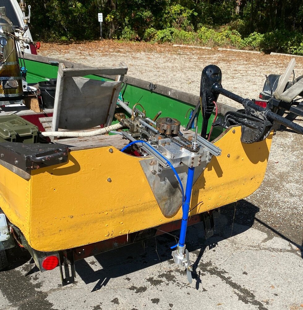

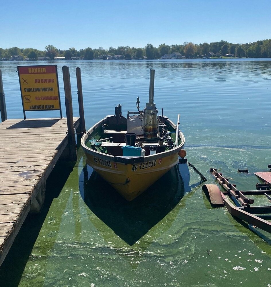

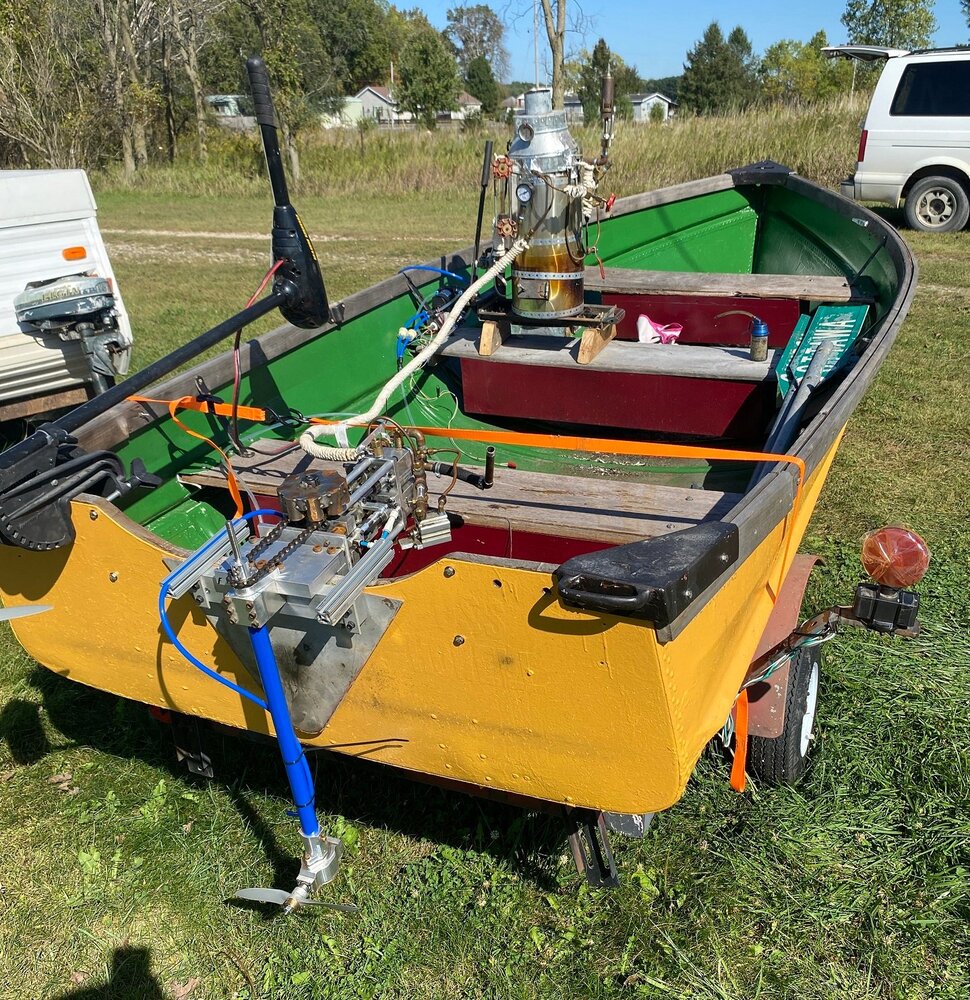

We finally did it! A new steam boat enters the world!
The boat is registered, I got everything I needed, and the engine is ready. Note the 70 year old 2stroke outboard in the background that already left me stranded in the water, it's days are numbered. First thing's first, I did the new boater thing. (forgot to put the plug in). After fixing that, I left the boat ramp with the trolling motor. There wasn't any traffic, but there was a big algae bloom I didn't want in the boiler.
The trip was almost cut short after a frustrating few minutes trying to light the firestarters with matches.
But we eventually got the fire started, the gauge needle lifted, and the engine warmed up. Time to give it the beans! Well, like two and a half beans.
Success! After putting around in circles for an hour or so, I motored back to the ramp under power of steam. Post water inspection. The outboard survived. The upholstery on my old beach chair did not. The day was a total success, everything worked (almost) flawlessly!
Post game analysis, starting with the good:
Nothing broke, the boiler boiled, and the engine ran. It was very torquey, you can see the whole boat move every time it rotated.
Having ball bearings on almost everything on the engine was nice, as I didn't have to worry about oiling everything, just one squirt on the eccentric. The o-rings held up just fine too.
The boiler electrode, water level controller, and water pump worked flawlessly*. I never lost prime, and the intake tubing on the outboard stem seems like a good spot for it.
The boiler didn't seem to mind the lake water, there wasn't any excess foaming except when blowing the whistle.
Maintaining a strong fire was an every minute job, but not difficult with wood pellets. Every minute or so I pushed the pellets in the doorway down into the firebox, and made a new doorway pile with 2-3 scoops.
The outboard gearbox and propeller didn't break.
Now the bad:
I need a rudder! Without it the boat slowly goes in circles, and using an oar to keep straight sucks.
The boiler is too small! I was seriously over firing this little thing, with stack temps of 700-800f. Even with this, the boiler was never able to sustain anything above 60psi. Even so, I only went through one gallon of wood pellets in an hour. I only managed about 3mph max.
My engine timing is terrible in this direction. I really wasn't able to notch up at all going forward, while I could smoothly adjust the cutoff in the reverse direction. Instead of trying to figure that out, I'm just going to get props that spin the other way. After all, it is a hackworth.
The water pump has a built in pressure switch for RV use, and I forgot to screw the adjustment all the way in on this one. So it didn't want to kick on above 60psi or so. However the hand pump was plenty, and I fixed this as soon as I got home. Otherwise it maintained a perfect water level without short cycling.
The outboard mounting clamps are garbage. You can see the whole engine rock every time it spun. I'll have to fab something much sturdier up. I might add a block lower on the outboard stem to help distribute the forces.
The steam line from the boiler to the engine needs to be secured in place. It was constantly swinging, and that's gonna fatigue it out.
I need a removable mounting system for the boiler. I just screwed it to the bench with wood screws for this run, which is bad. I also want to put it on the rear bench if keeping the fire up isn't too inconvenient there.
I might want a lower pitch propeller on it. This was an 11x7 APC prop, and I don't think the engine was able to spin fast enough to shorten the cutoff. I'll try a 5 pitch next time.
I need bigger water filters. I had two little ones in parallel, but the pleats immediately crushed a little bit. The water pump has a fairly high flow rate.
Oh, I also need to route the exhaust line better. It's currently hilarious.
