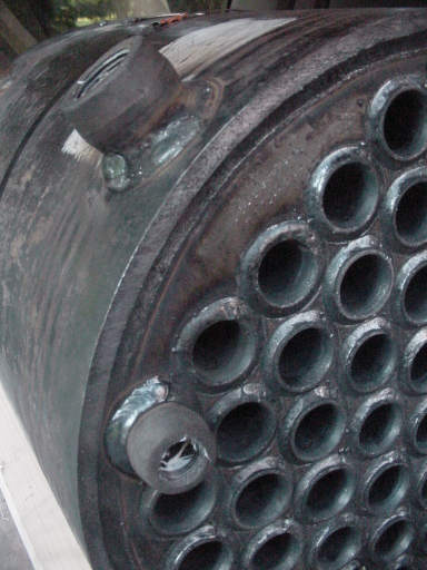

On my Beckman VFT boiler they appear to have used a pipe reducer welded in place. Only a small amount of protrusion from the surface of the shell. This gives me a lot of freedom of choice in the future about how long of a schedule 80 nipple I might like to use. Also, there are a lot of extra ones on the boiler which I have plugged with ordinary pipe plugs and covered up with the insulation and lagging. You never know what you might want to do later.
With proper welding practice, such as the right bevel, it would certainly be strong enough. Black iron (mild steel), of course. No galvanized.
