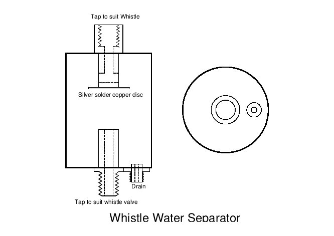

3. Finally one can provide somewhere for the water to go. While perusing a 1915 book that was the standard text given to the American Naval cadets at that time I came across a reference to how it was done in their battleships. Essentially, it was expected that the whistle pipe would fill with water so a water separator was placed on the whistle side of the whistle valve. The water never got to the whistle. Looking at the diagrams I have made up a smaller version that will go in my boat.

I will really want to hear how well that works. I understand how a normal steam trap works (or is supposed to work) but that design looks like the water droplets would just shoot right out of the entrance and into the exit. If it works, there will be a lot of us building them!

Oops! I see it now. It's a disk, not a washer.
