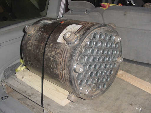

- VFT 20 sq ft 48 tubes, 1.25 x 0.095 16 inch shell 18 in long
- SW Boiler Shell.jpg (24.79 KiB) Viewed 5493 times
