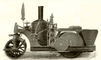

I think it is either an industrial hoisting engine or an engine from a steamroller. It is built heavier than typical for a marine engine, and certianly too heavy for an automotive engine. Early steamrollers followed steam traction engine practice, but later models used this type of engine for quick and sure reversals so that the road surface would not get a "dent", which often occured with IC engined rollers.
- buffalo steam roller.jpg (6.12 KiB) Viewed 12096 times
Edward

The governor seems to be a bit out of place for any mobile application....I think ??
Edward
Edward

The Governor on the Craiglist Engine seems to match the Governor on the Buffalo Steam Roller?
- Buffalo Steam Roller
- buffalo steam roller.jpg (13.62 KiB) Viewed 12071 times

Indeed it does , I stand corrected . Its the first time I've seen a governor on anything other than a static engine . Was this common practice in North America ?
Edward .
Edward .
