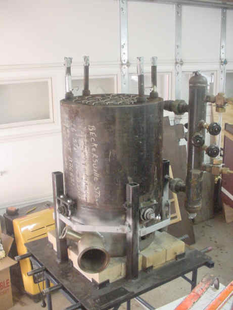

The Margaret S. has its VFT Boiler mounted on a 1/4 inch thick, 24 inch x 24 inch steel plate. Two inch thick firebrick is used between the firepot (which glows a dull red when continuously underway), followed by a 1/2 inch thick layer of kaowool on top of the steel. The steel plate did get very warm, but not hot enough to damage the wood/epoxy frames in the boat.
I had made provisions to put cooling water on the steel plate (see four pipes, welded to the bottom of the steel plate) if it got too hot, but found this cooling system to be unnecessary. Allowing air circulation around the bottom of the steel plate provides enough cooling such that the firebrick & kaowool layers provide enough insulation. If good insulation was to be used under the steel, then the temperature of the steel plate would rise considerably, possibly damaging the wood frames.

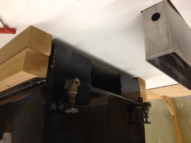

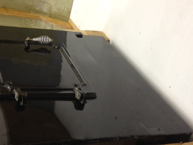

Reading these posts I am starting to have misgivings about how I am setting my boiler up. I have a water tube with a pretty deep ash pan under the grate. I have set it in place with about 1 inch of air space between the metal floor of the ash pan and the boat floor. Hopefully you can see that in the attached pictures.
am I asking for trouble ?
jon

Re: Boiler Installation
sorry about the picture orientation....................................
Wood ash is actually a very good insulator, and an inch or so of the stuff in the ash pan would significantly cut down any heating of the floor. For your setup, it is recommended that you put a wet pan, the size of your ashpan, in the space under the ashpan. This wet pan should be about 1/2 inch deep, and some old cotton toweling is set into the pan. Water is then added, the cotton will keep it from splashing out when underway.
Pay attention to the temperature of this pan, and how often you have to add water to the pan, keeping all the cotton wet. The water in the pan will positively keep this area at or below 212F/100C. If the supply of water is too much for conveinent operation, then some modifications would be required, however the setup recommended here will let you know if there are problems, and will protect your floor from excessive temperatures.
