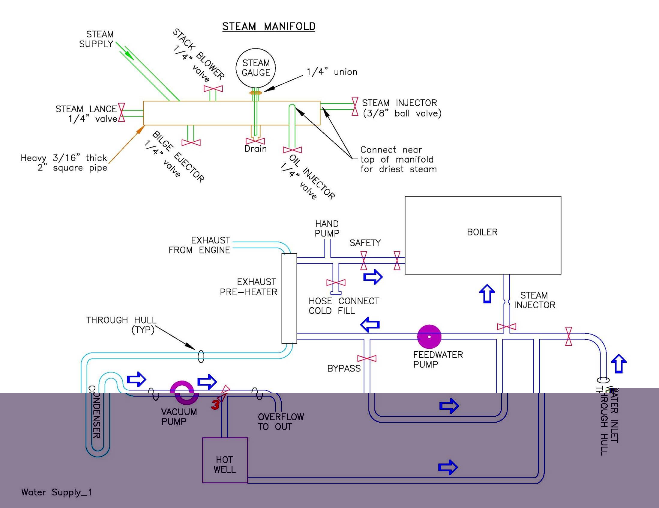

The folks I run with would shutter at anything less than hard, schedule 80 steel for steam lines. It's a pain to work with, especially when bending, but combined with good quality stainless valves ensures you'll be steaming safely a long time.
In regard to your quest for a simple drawing showing feed lines, I hope this comes along, a drawing I made when trying to get a handle on how to plumb the feedwater. Also on the drawing is a sketch of the steam manifold which is a copy of my mentor's.
