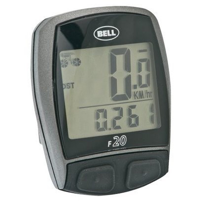

Revolutions Per Minute = RPM Meter = Tachometer, the best easy way to do this is with a bycycle speedometer. A small magnet attached to a flywheel signals every revolution, they come wired or wireless. Buy one for 10-15 USD, and set it so that the kM/hr indication is indicating some multiple of RPM. For example, if your engine runs to 400 RPM, set up the bicyle speedometer to indicate 40.0 kM/hr at that Engine RPM. Now you have a very accurate tachometer that will read from 0 - 99.9 kM/hr, corresponding to 0 - 999 RPM.
These electronic speedometers need to have a user input of the size bicycle tire that is being monitored for speed. You want to find a bycycle wheel diameter that will be turning 400RPM when it is traveling at 40kM/hr. That comes out to a wheel diameter of 530 mm, or 20.88 inches.
The math is fairly simple, at 40 kM/hr = 40,000 Meters per hour / 60 minutes pre hour = 666.666 Meters per minute. The wheel we are looking for turns 400 revolutions per minute, so at 40 kM/hr, it will traverse 666.666/400 = 1.666 Meters per revolution. Some bike speedometers require input of this single revolution distance, in mm, and that is 1666 mm per revolution. Other speedometers need input of wheel diameter, which is the distance divided by PI (3.14), in this case 1666/3.14 = 530mm diameter, or 530/25.4 = 20.88 inches diameter.
For my sidewheeler, engine RPM is less than 100, so I want the bike speedometer to show 50 MPH when the engine is turning 50 RPM. Same calculation @50 MPH, 50 x 5280 / 60 = 4400 feet per minute. at 50 RPM, each revolution would cover 4400 feet / 50 revolutions = 88 feet per revolution, so I would need to input a 28 feet wheel diameter = 336 inches (I wonder if the device would take this). Alternately I could choose the kM/hr display, giving 50RPM = 50 kM/hr, with an input of 16666mm per revolution, or 5304 mm ( 209 inch dia) wheel diameter (I wonder if the device would take this).

Some of the bike tachs use the circumference of the wheel in mm. The correct number for them is 2682.
Re: Rev Counter
If your speedometer is set to display kilometers per hour, the circumference entry would be 1,666 mm (65.6 inches) per wheel revolution. If your speedometer is set to display miles per hour, the circumference entry would be 2,682 mm (105.5 inches) per wheel revolution.
Either way you get the display to indicate RPM where the LCD display of 99.9 would correspond to 999 RPM of the actual machine.
