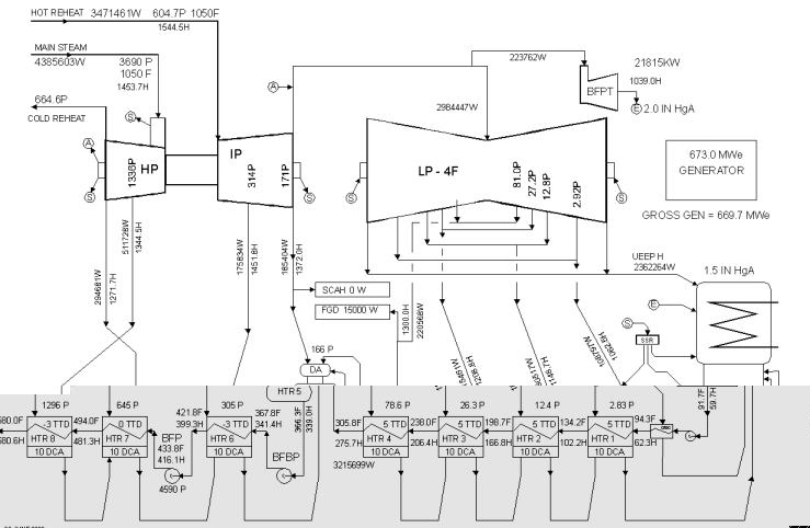

"Where will this all end!"
Power cycle of one recent steam power plant, not counting the steam generator, economizer, air heaters, reheater, superheaters, etc., just the basic steam & feedwater power cycle.
- ELM HBD.jpg (55.69 KiB) Viewed 8573 times
Re: On the water testing of Folly
Horrifying!! Even scared the cat.
This diagram, however, comes from a guy caught on 'film' paddling his hull. You Luddite!
