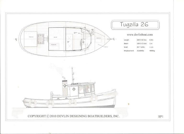

attachment shows a 27 foot tug with a displacement of 10600 lbs, dead weight not known. according to the waterline formula it has a hull speed of about 6.25 knots. Can anyone give me an idea of what HP steam engine and size boiler I'm looking at? Sure like to get this nailed down as close as possible any advice helps. Thanks, George

Re: engine horse power
Nice profile on that George! Looks the Biz.
Hi George,
For just general cruising, I would go for around 6-8 horsepower.
The horsepower comes from the boiler, so for that amount of power out of a VFT, about 60 sq ft of heating surface. More or equal to that for wood or coal, a little less for oil or propane. The engine? Run a small engine fast or big engine slow for the same net torque. I would also suggest a twin. The tug I have now has one and I really like it. 3+3X4, that would be plenty for yours. Whichever way you go on the boiler and engine, it will work, even a smaller 3X4 single and 30 sq ft VFT will push it, it just won't get near hull speed. And then again - it might.
Engine horsepower ratings are a bit ambiguous. My buddy has a steambike (Tony Grzyb on http://youtu.be/piv_P7AiKUY ), he has a 1/4 hp rated Strelinger coke bottle engine on it. However, with it's boiler and the RPM he runs it at, it puts out more than 3 hp.
How are you planning to arrange the engine and boiler?
