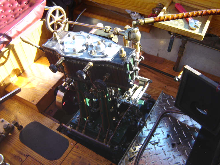

Re: Launch Engines - Power Output
Thanks for posting these Fred.
Is that a Blackstaff-Wood compound I spy?
Not sure what type of engine here, just a nice looking compound found in my photo archives.
Of course, finding the output of a compound is somewhat more difficult than a simple engine, as the HP cylinder works between Main Steam pressure and intermediate pressure (usually aboit 1/3 HP inlet), and the LP cylinder works between the intermediate pressure and exhaust pressure. There is a good discussion about output of compound engines in the "engines and boilers" section of this forum. One method for this evaluation involves calculations for two "engines", the first is the HP cylinder, the second is the LP cylinder, then the two outputs are added for the total power.
