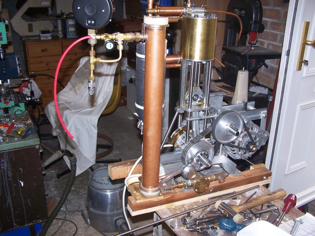

I have been working on various designs of monotube boilers over the last few years and find the views on this forum most interesting. My original challenge was to design and build a 3HP double acting steam engine and boiler from scratch to fit in a dinghy. It needed to be light so much of the engine is ally with sealed ballraces throughout. The boiler had to be monotube for safety.
The engine is fine and chugs away quite happily at about 800 RPM. It has some unusual features. The flywheel is driven by a timing belt at 3:1 above crankshaft speed, this enables the use of a flywheel that is only 1/3 of the weight and also the engine can be mounted lower in the hull reducing shaft angle and lowering the C of G. The weight of the engine assembly including condenser and scavenge pump (but not the boiler) is only 34 lbs.

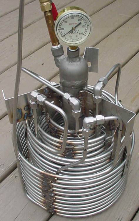

My first steam boat had a 5 square foot monotube boiler, pumping water in at about 200% of the steam flow, to assure the coils were always kept wet. A separator tank bled off the excess water, which flowed back to the feed tank. There was a counterflow heat exchanger so that the return (hot) water would pre-heat the incoming cold high pressure feedwater. This worked well with no problems of surging or other anomolies. There is no reason to fear a pressure vessel if it is designed and built properly. The separator tank does not even have to be a fired pressure vessel if it is kept out of the flue gas area.

- 5 sq ft 1/4 OD x 0.035 wall Monotube

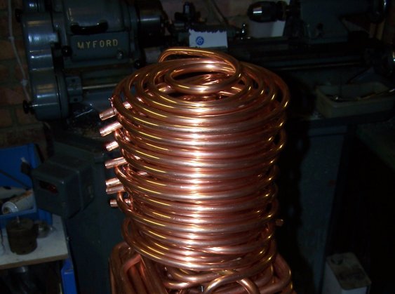

I like the idea of keeping it simple, I’m fed up with messing about with PICs and complicated control systems. I could use my original economiser coil (80ft of 3/8 copper) as the main one and my Lamont separator. If the coil is maintained fully flooded it should not need to be stainless steel. I may need to have a separate superheater coil between the separator and the engine.

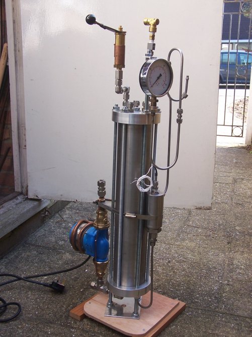

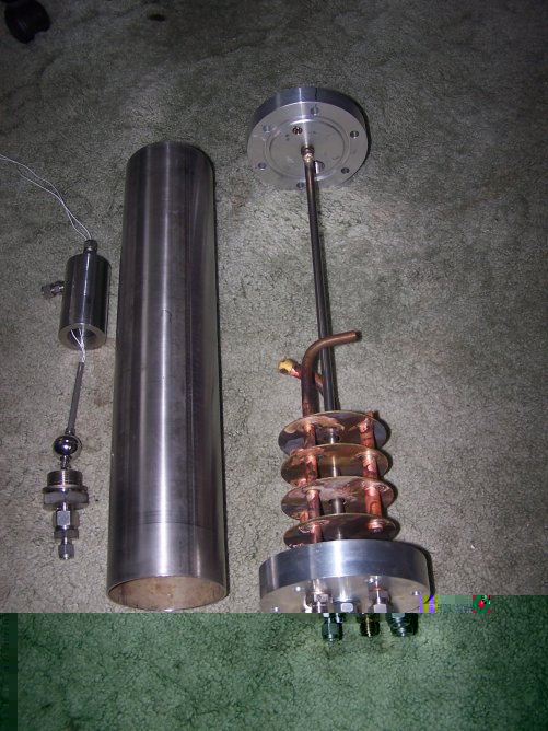

The float switch was suppose to monitor the water level in the separator and run the electric feed pump as necessary but it was not very successful. I think there was too much turbulence and in the end I replaced it with a bleed valve to maintain water level. The pump was then run from an algorithm derived from the gas valve and various temperature sensors. This worked quite well. The burners were from our old central heating boiler, re-jetted for low pressure propane. They were very quiet and controllable but susseptable to wind and not really the right shape; I may try making my own this time.

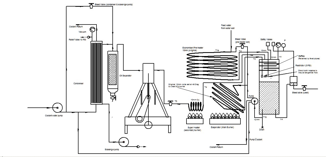

The coils I did by hand. 10mm Cu tube is quite soft when annealed. I have attached a layout of my last Lamont design.
- My Last Lamont Layout
- Lamont3.jpg (105.33 KiB) Viewed 13508 times
