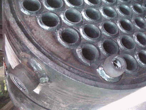

Along a similar vein, what are the rules for welding things TO the boiler? It's on the outside, and it's not pressure bearing directly, but presumably the spot where you weld is now slightly weaker...
Re: The Motherload
Yes, there are many pages in the boiler code addressing connections to the pressure parts, their strength and their reinforcements, etc. These rules probably occupy more than 100 pages of text, figures, diagrams, etc. within the ASME Boiler and Pressure Vessel Code.stevey_frac wrote:Along a similar vein, what are the rules for welding things TO the boiler? It's on the outside, and it's not pressure bearing directly, but presumably the spot where you weld is now slightly weaker...
For many of our purposes, simple reinforced and full penetration welded connections are allowed, with standard fittings specifically designed for these applications, such as A-105 "thread-o-lets" and "weld-o-lets". There is a good amount of discussion on another thread within this forum: starting on page 3 of the forum thread "From napkins to fabrication VFT boiler design"
