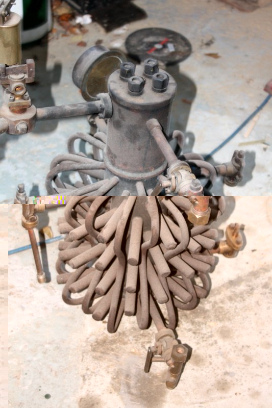

I havn't built one- but I have recently stripped one down to it's bare bones and if you like I could take photos and post them on here?

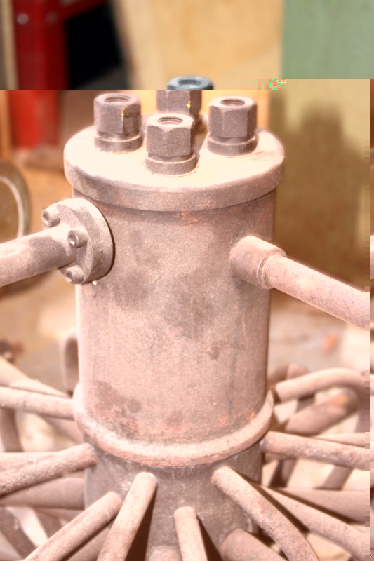

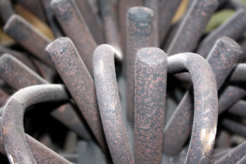

Hi,
A few pics as promised;
Greg
Greg

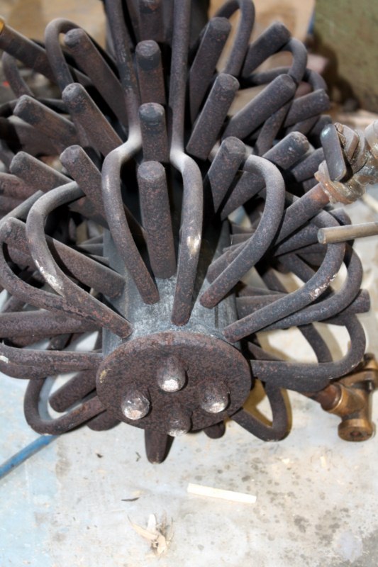

Re: anyone built a porcupine boiler?
Couple more;
- Porc 5 ed [800x600].jpg (72.89 KiB) Viewed 18949 times

I have often thought about porkeys..seems so simple to build. I would really like to see the insides of an old porky to see if they have deposits built up. Seems that would reveal something about their circulation.gondolier88 wrote:I havn't built one- but I have recently stripped one down to it's bare bones and if you like I could take photos and post them on here?

What are the curved pipes running from the top to the bottom of the main drum, between the quills?
I have seen similar pipes on a few porcupine boilers on the internet, but Googling has not yielded any answers, and they are neither shown nor mentioned in SB&MSL. Are they for circulation ("downcomers")?
Brenton,
I think they're just there to get in as much heating surface possible. In the central vertical drum boiler designs, the drum is effectively one big downcomer.
There is a central vertical drum design that consists of nothing but those tubes, I've forgotten the name of the design at the moment.
I believe you're thinking of the lifu boiler.
The porcupine boiler has large gaps at the outside of the quills, allowing the gasses to pass without transferring heat, these fill those gaps.
