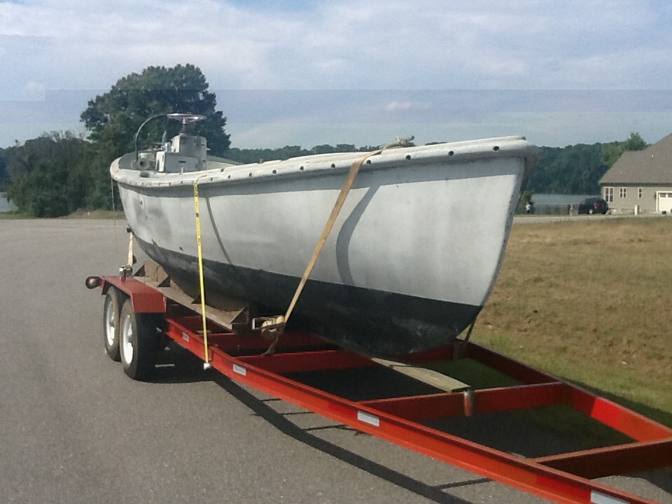

Some pic of whaleboat and engine
Whaleboat hull
Whaleboat hull
26 x 8 ex US Navy whale boat with Perkins 4.108

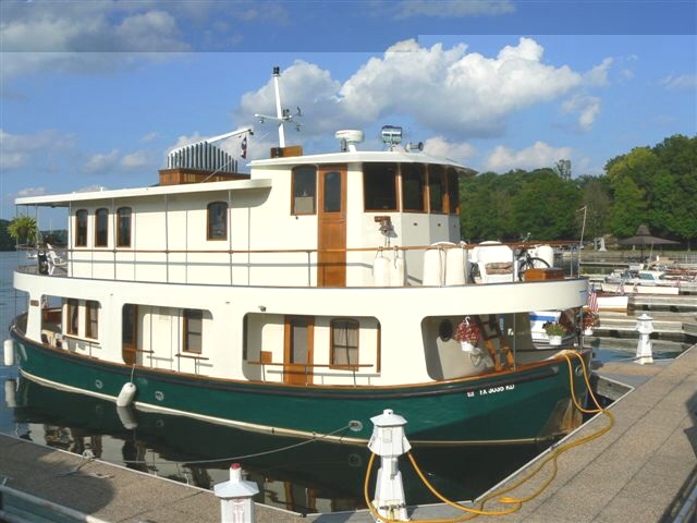

Annie. My other boat. All wood. Scratch boat over 16 years. Noisey  Cummins diesels. Lives on the Tennessee River. Has a 61 note calliope.

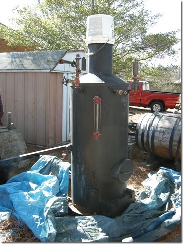

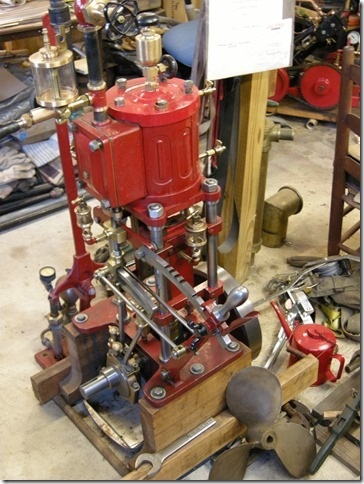

Pics of engine and boiler.
Semple 40ht boiler
Semple 40ht boiler
My engine ?7hp
My engine ?7hp
