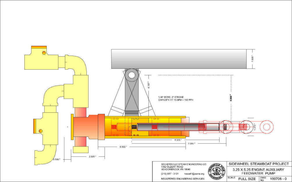

Hello, I have been weathered in a bit so I proceeded to make a boiler feed pump to back up the small hand pump already on my boat. I hope there are pictures attached. I would welcome any advice on the piece & would also like some input on the type of packing that works best.
This was made with a cylinder & plunger that was a botched reproduction for a Locomobile car - the cylinder was bored right through the valve area. The lever geometry is the same as the original pump. The cylinder is red brass & the plunger is an unknown alloy of stainless steel.

Nice work! Especially like the pump frame, with the contoured bolt holes, plus the guide of the piston rod to eliminate side thrust forces.
My hand feed pump uses ordinary 1-1/4 inch brass pipe for the cylinder, a brass plug plunger, with two O-ring grooves cut about 1/8 inch wide x 1/8 inch deep on the piston plunger. The O-rings are spaced about 1/2 inch apart, with waterproof plumbers grease between the O-rings. This pump has been in service for 3 years now, has never been taken down, and has never given trouble. No visible water getting past the O-rings.
The O-ring outside diameter setting in the groove is 0.002 - 0.003 inch more than the cylinder bore, per inch of bore. The O-ring manual directs that the O-ring groove volume should be filled by the O-ring 80-85% when compressed into the cylinder bore. If you compress the O-ring more than that it will be a tight fit, and probably will wear out faster. Break the sharp edges of the O-ring grooves, so the rubber O-ring (Buna-N) will not be cut when being installed.
I have a 3/4 inch "Y" strainer, with 50 mesh stainless screen, and it finally got clogged with rust this summer (un-galvanized steel feed water tank), very much slowing pump suction capability. Cleaned the screen and all has worked well since then.

I've used O-rings and packing - both work just fine. For packing, I've had excellent luck with Teflon faucet packing.... if you have space, the traditional square stuff works well too.
It's easy to spot water leaks - air leaks are harder. I carry spare O-rings for my hand pump; I have replaced them three or four times in the 23 years Otter has been steaming.

Thank you for the replies. I have acquired some white Teflon square braided packing that was destined for use in a nuclear power plant. It looks to be worth trying.
