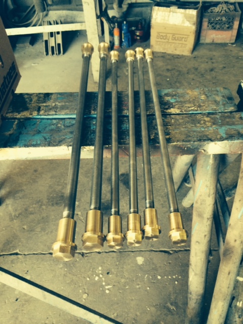

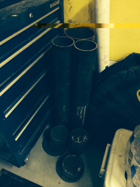

Well, here we go. i hope this goes well, i'll learn on the fly. End caps are almost done, I dont have a pic yet. But here's the drums, rough cut end caps, tie rods with finished nuts, and nuts before cutting the hex.

Looking good John,
what kind of material are the nuts made from?
johnp
Posts: 242
Boat Name: Cardinal Queen
Re: John King Boiler build
Post by johnp »
Aluminum bronze

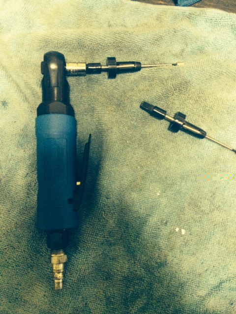

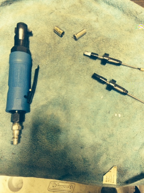

I think/hope this will work for my tube expanding, especially in the 4" mud drums.
I'm using a 1/4" drive air rachet and purchsed a 1/4" driven long socket, cut it before the hex starts so the square will fit over the wicksteed expander.

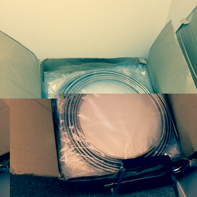

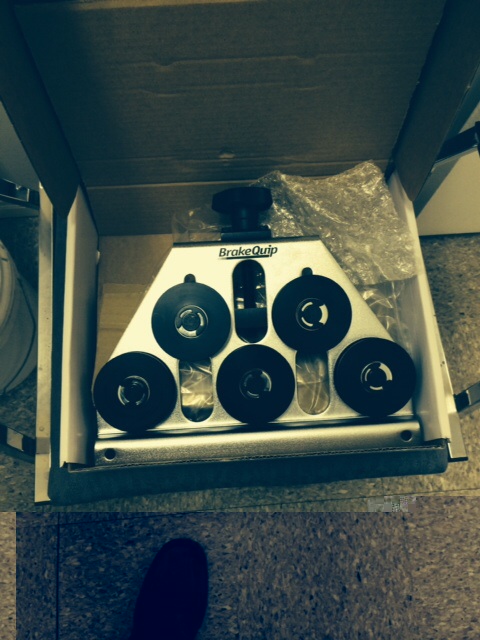

Cunifer tubes and straightener.

What size tubing are you using and who are you using for a supplier? Is it 90/10 or 70/30 alloy?
johnp
Posts: 242
Post by johnp »
12mm 90/10 from Dorset tube in the U.K.
