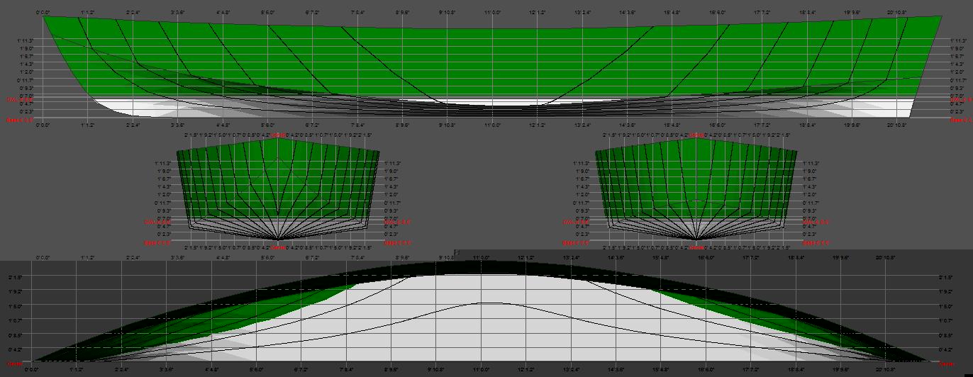

Something more like this, then?
- Durhamply_Linesplan.jpg (121.05 KiB) Viewed 13077 times
Oilking
- Posts: 186
- Location: Cathlamet, WA
Re: Preliminaries on the John Fitch
This is what I had in mind. The only thing I would suggest is to try lowering the point where the chine meets the stem to about 2/3 of the way down from the forpeak to the waterline. This is, for me, more a point of aesthetics than fuction. It leaves a cleaner line to the stem with maybe a little increase in the fullness of the bow below the waterline.
The finess if the stern area and straight sternpost should promote good rudder response and would make it simple to attach an outboard rudder.
Dave

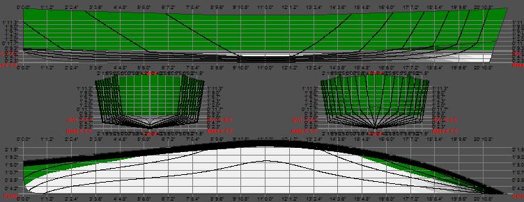

- Durhamply_Linesplan.jpg (76.29 KiB) Viewed 13059 times
Oilking
- Posts: 186
Ya, that looks better. Now you might grab a clear block of wood and see if you can make a half model close to what the lines show. If the finished sides or bottom can be formed with sand paper on a flat block, it will likely be a developed surface. This can also be checked by rocking the model on a flat surface like a table saw or piece of plate glass chcking for bumps or hollows. The half model is a check since not all computer renditions are infallible when it come to defining a developed surface.

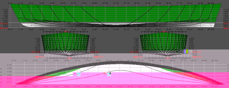

Something like this?
- Durhamply_Linesplan.jpg (53.98 KiB) Viewed 13009 times

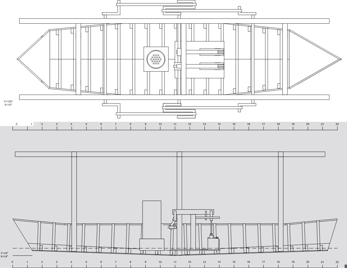

I've laid out the engine and boiler into the hull in Visio (details on Engine and Boiler can be seen in the other thread, here: http://thesteamboatingforum.net/forum/v ... ad7f5dc2a1). Note that for ease of modeling, I am drawing using the plywood version of the hull; in reality, I may have the strip-plank version built by a real boat builder.
I had a conversation this morning with Steve from Shaw and Tenney, a paddle/oar manufacturer back east who have been in business since 1858. He was very helpful in determining the most efficient oar for the boat: a set of 12 will cost around $1,500 (much less than I was expecting).
- Boat.jpg (121.18 KiB) Viewed 12922 times

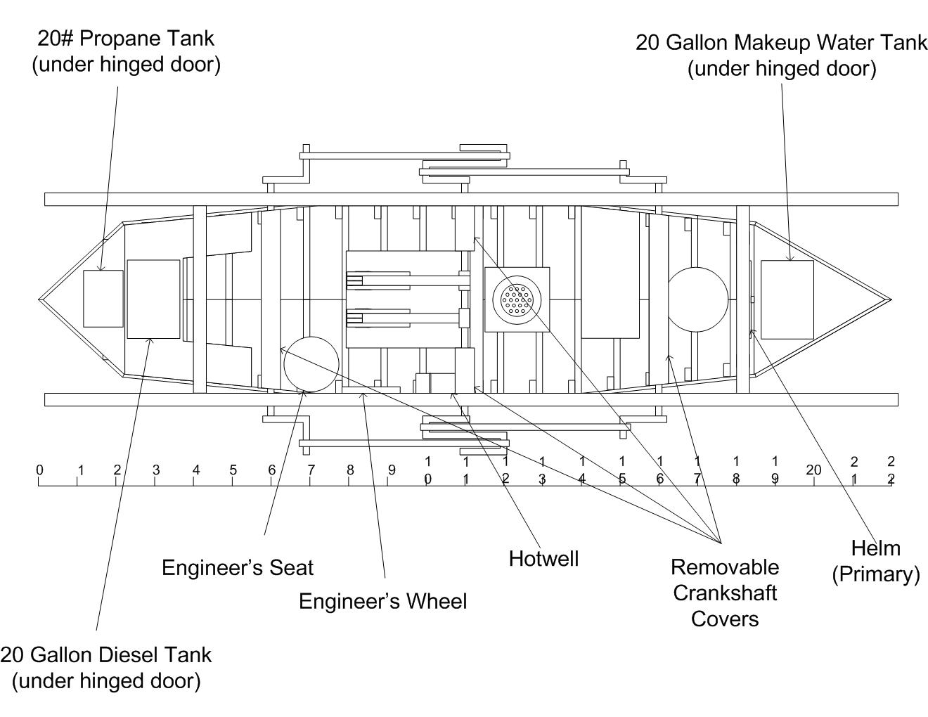

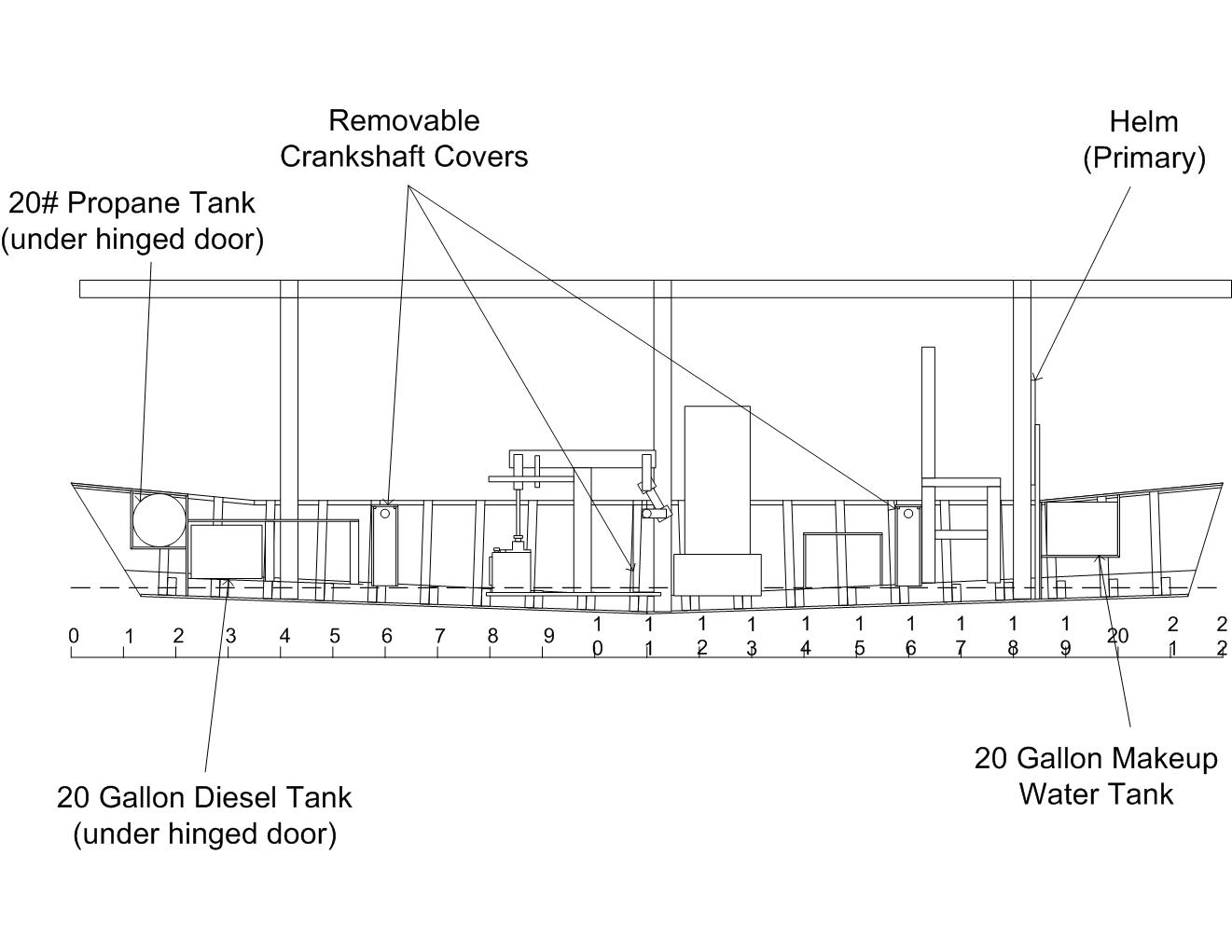

I have laid out seats, tanks, helms, and a few auxiliary items in Visio. This, I think, is as far as I will try to go before seeing some launches up close at the Great Delta Steamboat Meet at the end of the month.
- BoatTop.jpg (126.91 KiB) Viewed 12850 times
- BoatSection.jpg (99.65 KiB) Viewed 12850 times
