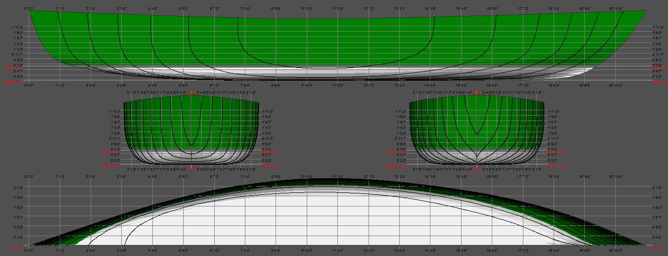

Here is the lineplan I came up with in DELFTship (it's not Revit or Solidworks, but it's not AutoCAD 1997 either). My line of thinking is that if I am going to build a hull myself, it's going to need to be simple, rugged, and stable (I can pretty it up after it doesn't sink), especially given the superstructure that it will have to support for the paddles.
The design below reflects about the extent to which I would be willing to go as far as hull complexity; something along the lines of what others above have described - flat (perhaps angled, but still straight) plywood sides, meeting at a flat plywood bottom. Of course, I'll take whatever performance I can get out of it (it is good to do things well), but if I were pushing for speed I would have stuck with traction engines (or perhaps stationaries) /sarc.
Buying a premade hull would mean finding one with the appropriate shape, size, and price. Nothing is technically impossible (I've heard you can fold a piece of paper nine times, if it's the size of a small building and you use a forklift), and I'll keep looking.
The important thing is that I've got a lot of time yet before even moving to Phoenix, so I won't be able to start constructing even a model until at least next year, and I'll have plenty of time to work out the details.
I'll keep up with the planning of the project as things go along, so at the very least, everyone will get to enjoy the anticipation ("You'll see it's all a show, you'll be laughing as you go..."). i imagine there is a reason no one has built a working full-scale Indian Paddle mechanism, and I'm sure it will take support from the whole steamboating community.
To that end, I am planning on attending the Great Delta Steamboat Meet this year with my father (contacted the Blaines last weekend) so I can get a close-up look at the design and construction of the hulls (my boatbuilding experience consisting of participating in a Nail-and-Sail two years ago, this will be the newest element for me), and, of course, the power plants.
- Brenton
- Brenton
- New model_Linesplan.jpg (75.18 KiB) Viewed 16462 times

A couple of comments:
1. You will want to kick the bottom up in the stern unless you are planning a plaining hull,which I doubt. Start 5 to 6 frames ahead, and end with the bottom at or a little above the transom. This will keep you form dragging a mass of that will boil up arount the stern, and leave a little more room for the prop.
2. If you are going to be building with plywood you will need a hull form that consists of developed surfaces. These are surfaces that bend in one direction such as flats, cones spirals and cylinders. This is not intuitive, but the frames will be curved as you move toward the bow as well as the stem where the sides meet. It's been a while since iI have played with Delft, but I think it ha a developed surface mode tha makes this easy to see.
Simple skiffs are often built with only three molds, the stem, transom, and one in between. Depending on the flare to the sides and the spacing the plywood will go where it wants, and the desired frames can be paterned and fitted to it. Modeling with some poster board can be a big help in visualizing this.
Good Dreamn & Good Steamn
Dave

My first comment should have read: Starting 5 to 6 frames ahead ending at the transom with the bottom a little above the waterline.
Dave

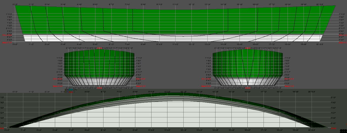

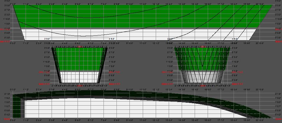

Two hours in DELFTship later, I have two versions of the Durham boat hull - a historically accurate, strip-planked replica, and a simplified, 3-chine plywood version. I will probably fair the lines a bit more, but they're mostly where I think I want them to be.
- Plywood
- Durhamply_Linesplan.jpg (112.15 KiB) Viewed 16399 times
- Strip Plank
- Durham_Linesplan.jpg (114.58 KiB) Viewed 16399 times

I see what you're wanting to do now. On the developed hull I would suggest a single chine vee bottom with the sides extending a little below the waterline at mid length, and a slight warpped bottom that will let the chine rise at each end. Also a curved plywood surface has inherently more stiffness than a flat one.
Your round bilged hull looks sweet, and would make a nice strip plank project.
A boat building rule of thumb is the length of time to complete the project will be proportional to its number of parts.
Strip plank many parts--plywood fewer parts.
Dave
