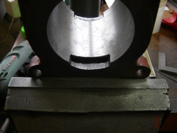

I spent a large amount of time cutting back the ports and then gas-flowing them, very reminiscent of days-gone-by trying to get too much go, out of too small, two-strokes. I won a blister from the filing. :roll: :roll:

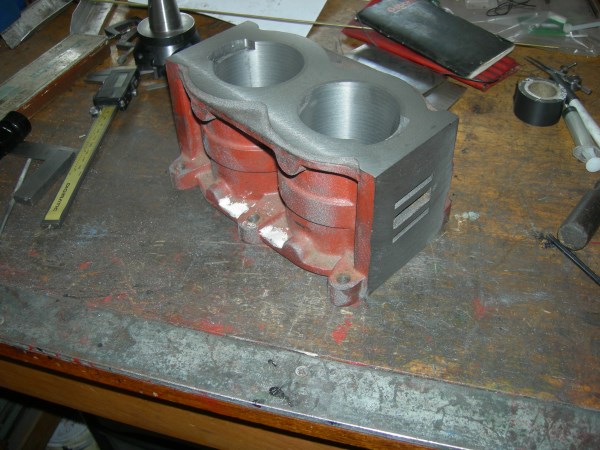

Once the liner has been cut back that too will need a little 'treatment' on the inside edge. At least the ports seem to be plenty big enough through to the steam chest face.
I got the liners finished, and fitted, with a drop of loc-tite round the port area just in case there should be any thoughts of leakage.

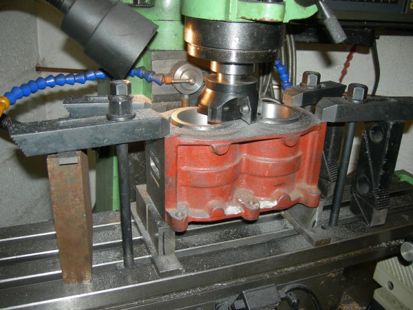

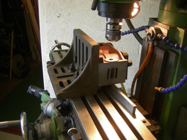

Having cleaned the liners down to face level top and bottom. The existing ports are a little bigger than 1/8", but not 3/16" wide, so I milled them ports down 1/4", to allow the cylinder covers about a 1/16" register into the bore. I then fly-cut the bottom to get rid of the slight warp (about 0.005"). At that point I decided that I might as well fly-cut all the faces to make sure everything was true. In the end it seems it was, as all I took off the top and valve faces was 0.002"

I am now left with a few thou less than 3.5" between the port edges, so should have no difficulty with the 3" stroke that I first envisaged. The final bores are both around a thou under 2.5", but I haven't honed them yet as I haven't decided if it's really necessary. Rings I already have in stock.

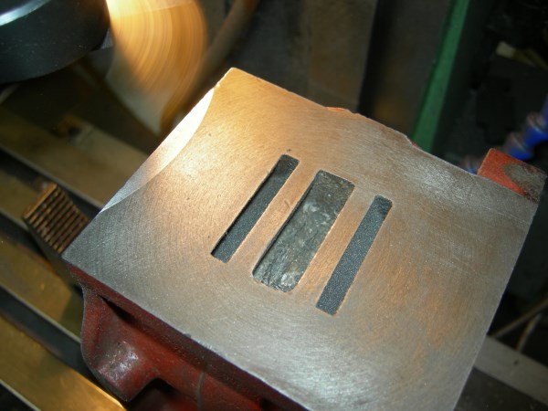

After the valve faces etc. I cleaned off and drilled the exhaust outlets and faced the drain-cock bosses.

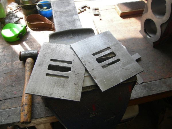

Then I attempted the port plates which proved slightly troublesome with a long-series cutter that decided it knew better than me, where it should cut. Once I went back to the standard length it worked out fine.
Port Plates (600 x 450).jpg (61.03 KiB) Viewed 33254 times
The ports on this seem to me to be more than adequate, even generous, at 1.5" by 0.200" (steam) and 0.450" (exhaust), but I suppose that the important bit is that they are big enough, and in no way restricting, the slide-valve will be doing the actual work.

What kind of toolholder do you have chucked up in that first picture?
I might of missed something, but whats the reasoning behind the port plates?
Re: And Now for the Twin
Ken, the tool holder is just a collet chuck, without the cutter (I nearly forgot to take the photo).
If you look back to the first post you'll see the problem with the ports in one of the photos (3rd), I reckoned that there was too much miss-alignment to correct without making the steam port too wide, or the bridge too narrow (or both). Granted it would have been nicer to have a gun-metal v-slide running on cast, rather than mild steel, but what the heck, summat had to give. :lol:
marinesteam
Posts: 313
Boat Name: Idris
Location: Colorado USA
Post by marinesteam »
I didn't read back that far :oops:
Could have angled the valve to match :lol:
Hmmm! :? Never thought of that! ;)

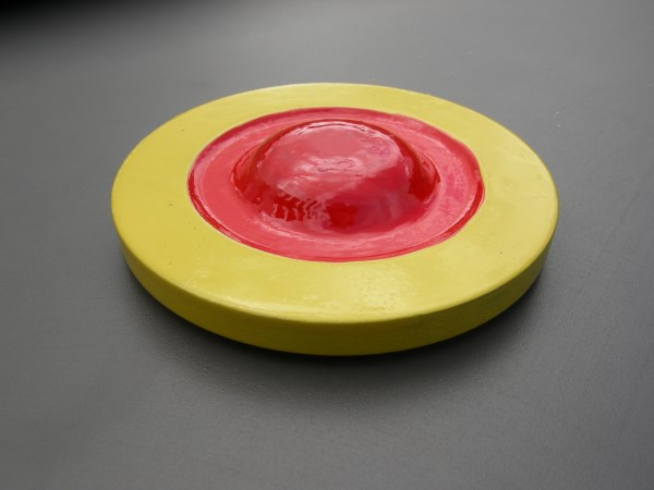

A single pattern for the two cylinder top covers. They will need a flat where they meet, but it was easier to produce the pattern without it. I will need to produce some of the other patterns before contacting a foundry.
The sides look parallel or maybe it's just the picture. It may be a non-issue depending on the foundry, but all patterns should have tapered sides so they can get them out of the sand.
The best thing to do is contact the foundry first and ask them how they want them. I just went through that with one where my ideas and their procedure didn't coincide. :lol: It cost me about 4 weeks of waiting for parts I couldn't use.
