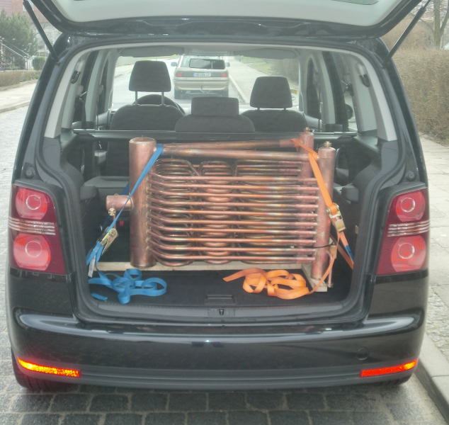

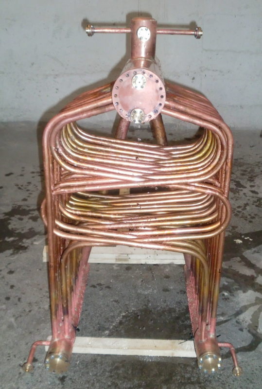

for coal firing i prefer a thre-drum-boiler. They have a bigger water-capacity than the ofeldts with vertical drum (up to three times).
There are a lot of designs for a three-drum different from yarrows like roberts or STUART Mandip (Kelly built such one for his RECIPROCA).
Here is one of my boilers built for a STUART 6a. The superheater and the feedwaterheater can be installed in the boiler so the plant is small enough for a little boat.
Best Dietrich

Very nice & interesting boiler. What are the dimensions of its main drum (especially its wall thickness)? What are the test pressure and the working pressure? Image
Thank you in advance.

Hello Christophe,
back your pardon for the late answer.
The boiler is desgned for a working pressure of 8 bar, it is tested with 12 bar cold water.
The Dimensions are:
- main drum 108 x 2,5 x 500 mm
- mud drums 64 x 2 x 500 mm,
- all watertubes 15 x 1 mm.
- total heating surface of the shown vessel 2,1 m².
The driven engine is a STUART 6a at 750 rpm.
Best Dietrich
