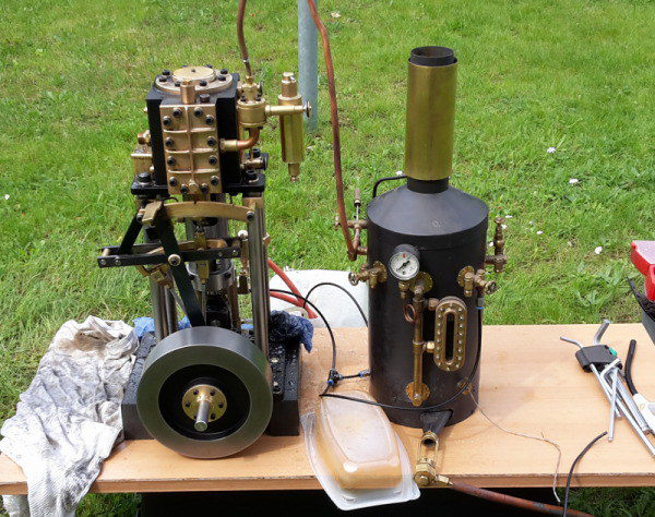

Re: Literature on Ofeldts?
Hi Fred,
It can also supply my 2 HP steam engine (HASBROUK #10) at low rpm to test its function.
How does it work - https://youtu.be/AgGv3aA5R78
Best Dietrich
you are right. There is enough steam to run a 32 x 38 mm double acting twin at 6 bar (84 psi) with 600 rpm.What a beautiful little boiler, looks like it would be perfect for a canoe size steamer.
Best Dietrich
Dietrich,
Nice boiler and engine, very good workmanship. That would be a great boiler for a steam bike.
