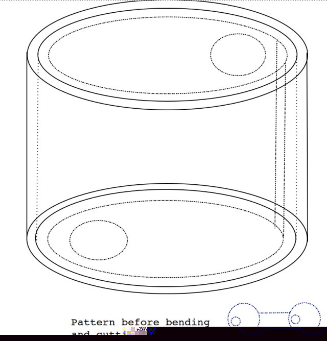

I was even thinkening for that - if I strategically bend and cut some mild steel sheet I could make an insert inside the PV steam dome to be a baffle. It would just float inside in the PV - and not super tight It's just supposed to help retard carry-over.
Ron. No, it is not practical for most and the run times will be short. But I already have a working boiler. This is going to be a small few hundred $ rig for testing and fun. Because it is limited and simple you don't have to commit to a full project and you don't have to worry about all things you must have for a boiler. As part of the insulation I can make it so I can just carry it to the vehicle/project if I need to. And if gets me hooked to steam land propulsion I'll talk to you about an olfelt.
- Baffle
- baffle.jpg (57.91 KiB) Viewed 12213 times
