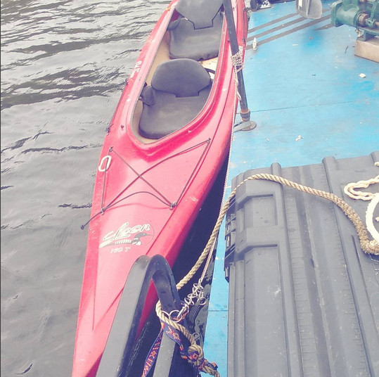

This is to give ideas. Nyitra's Deck is very convenient for a lot of things. Two of these are for Dogs(it's at a great level for them to hop on board) and Having a Kayak on the side for tendering or excursioning.
We have a few kayaks, but perfering larger seagoing kayaks this is a reasonable candidate...
- kayak.jpg (94.48 KiB) Viewed 192271 times

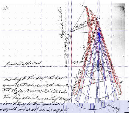

"Wonder if Fred could let me peak at any drawings of his John Fitch duck paddle mechanism?"
Some good video of the paddle mechanism on youtube, look up " John Fitch Steamboat". I just copied John Fitch's original drawing from 1788.
- Original Fitch Drawing, with Colour Overlay
- FITCH PADDLES-ss.jpg (27.55 KiB) Viewed 192259 times
- FitchStern.jpg (11.21 KiB) Viewed 192259 times

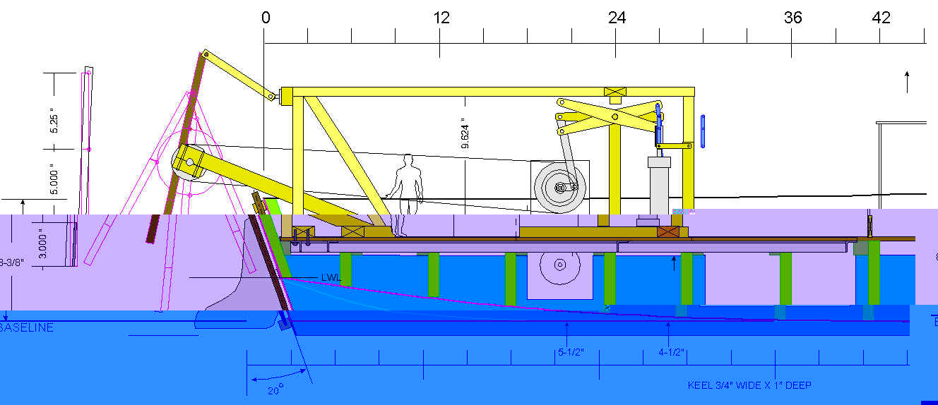

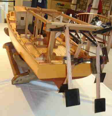

Re: What are the concerns/safety of an unfired >100C vessel
Fitch Model Drawing, showing layout of stern paddles and Watt engine.
- 6 ft model drawing
- fitchsternpaddles-engine.jpg (88 KiB) Viewed 192259 times
