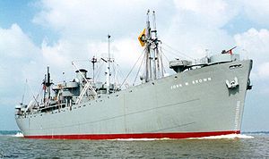

The most relevant information here comes from the largest fleet of reciprocating engine steamships, built with the highest level of knowledge for steam reciprocating machinery. This is the 2700 nearly identical Liberty Ships built during WWII. While steam turbines dominated naval ships, the shortage of steam turbine manufacture forced the building of these thousands of reciprocating triple expansion steamers.
While it is often quoted that these ships ran without oil cylinder lubrication, that is not actually correct. Yes, with ideal conditions cylinder oil could be reduced to a trifle, but every Liberty Ship fed oil to cylinders on occasion, and every Liberty Ship had an elaborate filter system to prevent oil in the steam condensate getting into the boilers.
I have tried to run my steamer with no cylinder oil, and even though I have very nearly ideal conditions according to literature (low speed, 60 RPM, nearly balanced valves, graphite impregnated rings and seals, 70 PSI wet low pressure steam) the engine gets very unhappy without lubrication. The rock shafts start to groan and use up much power just forcing the valve gear to move. To use another old saying that reflects my opinion here.... "I have heard if basements that are dry, but I ain't never seen one"
