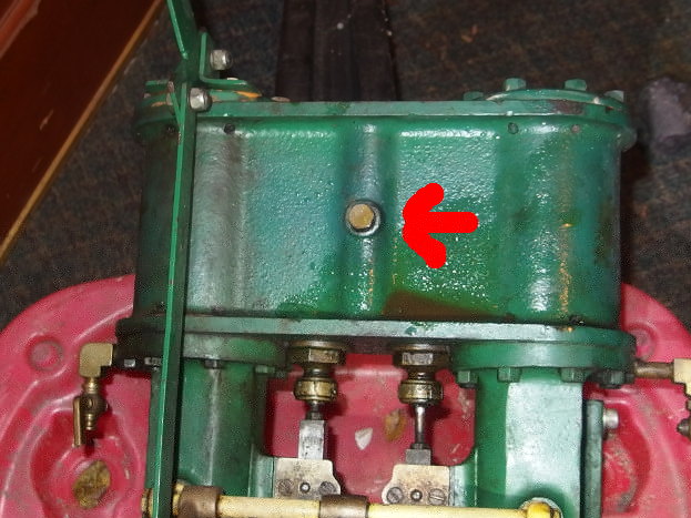

DetroiTug wrote:Quote: "the oil is fed to the inlet steam just before the valve and the steam pressure is continuously forcing the oil into the rings on the valve."
Are you talking about this plug that I may have just realized what it's for. :)
Plug on lubrication cap
