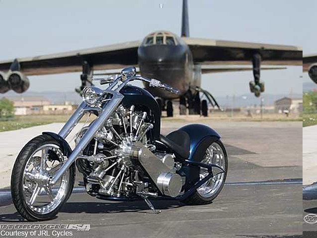

The next time your are driving down the road, take note of how many different types of motorbikes you see. All that any of the riders really need is a 100cc scooter to get them from A to B. However, they all have different personal needs and so they each choose something different. Sometimes a guy wants something that will be completely different to everybody else. So he goes and builds something that is quite impractical by many standards, it does not stick with tradition, it may in fact not be any better in any way at all, it may indeed have more negatives than positives, for transport he is probably better off with a scooter. I wonder how many motorbike experts threw cold water on this guy's idea before he built it.
Thank God he didn't listen to them, and he just went ahead and did his own thing.
One can only imagine the sweat pouring of the rider when he is sitting at the traffic lights while the engine cooks him alive. But he doesn't worry, he has achieved his goal, he has something different, something to be proud of, and nobody cares that the whole thing is unnecessary or impractical.

Re: Steam Actuated Inlet Valves?
Lionel Connell wrote:Mike,
But he doesn't worry, he has achieved his goal, he has something different, something to be proud of, and nobody cares that the whole thing is unnecessary or impractical, and just eats tyres (tires) for breakfast!
Lionel
Quote: "Fortunately these guys don't share your skepticism."
A model airplane engine at a hobby show?

I see bikes like this all the time. Choppers are the worst. Just non-functional junk as are most 'poser' machinery.
I believe fairly strongly in the concept of "Form Follows Function." There are good reasons for what we call retro or antique machines. Fairly obviously our boats are a great example of that. You want to ride fast down a winding road, buy a crotch rocket. Want to cover miles in comfort? Ride a Gold Wing. I rode a Jawa Speedway bike for a decade. Useless for anything but going sideways around a small oval dirt track. And on and on. But where does a modern Harley or the copies of it come in? Overweight, and underpowered and noisy. Just tools for male menopause. "Look at me! I'm different." So what?
What the heck does that hunk of junk with an aircraft engine accomplish besides making noise and offending everyone within earshot? Satisfy his ego? I'm not even slightly impressed. That engine was in the right place on the front of an airplane. Form follows function.
