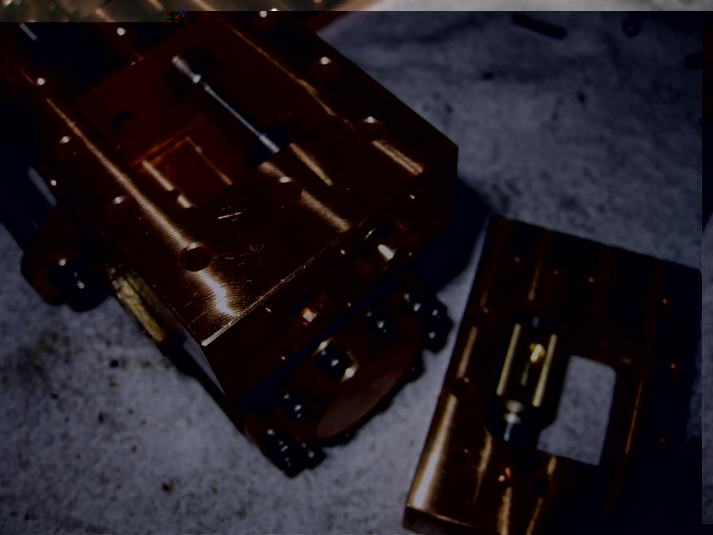

Quote: "My experience on a Fletcher Class destroyer with Worthington vertical pumps, that had free piston main valves, was often one of frustration. Not if, but when the main valve hung-up the only way to restore operation was to whack it with a 4lb hammer since there wasn't external means to move the valve."
I've never had that issue with the Southworth steam pump, not once ever has the shuttle piston stuck. It's a very close fit and Of course I do have an oiler on it.
