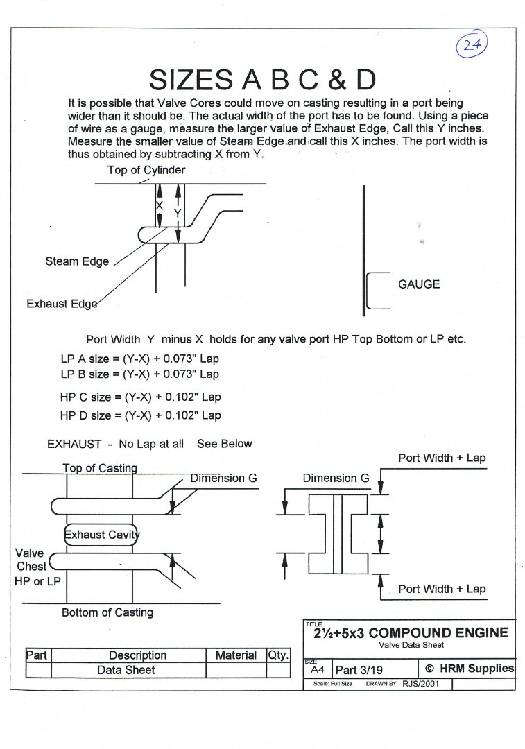

There is absolutely no point in fitting gauges to the drain cocks, carefully measure the dimensions of the ports taking the cylinder top as a datum. Please note these engines are “outside admission” Joy gear does not work well with “inside”.
Below is a copy of the data sheet for valve setting.

thank you for explanation and sheet. What dimensions have A, B,C and D? At my steam engines i have a lead of 1 mm so they run smoother, why you haven't in the sheet.

Jack, Thank you for the information and diagram. Where can I find a copy of these diagrams as I only have a few of the original sheets, the rest are hand drawn?
The piston valves are made of cast iron as of course are the cylinders. I have ordered some more cast iron to make the new ones and this drawing is a great help. On this engine the steam is only admitted to the top of the HP piston valve which is hollow to allow the steam to pass to the other end of the valve with the transfer port cast in.
Do you know if these figures for lead and lap are the preferred sizes as they are very specific?

The Cheape engine rights were sold to Hugh Mothersole who marketed them for a while and made a good set of drawings, the sheet above is a copy of one and is specific to this engine.
Hugh sold the rights to A.J. Reeves 2000 who market various bits/drawings for really silly money! I see this particular engine is not on their website but used to be??
The lead is not specified on this sheet, it is a function of the eccentric's angle of advance, I would suggest a small lead of 0.010 to 0.020" if it is possible to move the eccentrics, Either way you need to VERY ACCURATELY mark TDC & BDC to get this right.
