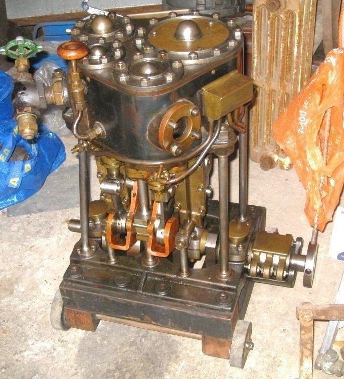

Gordon Cheape engines are a copy of the Savery compound and use "savery" gear, this is a version of Joy gear but uses swing links instead of the usual curved slide blocks. Below is a photo of a Savery compound, one of the last to be made (1912).
Jack
Jack

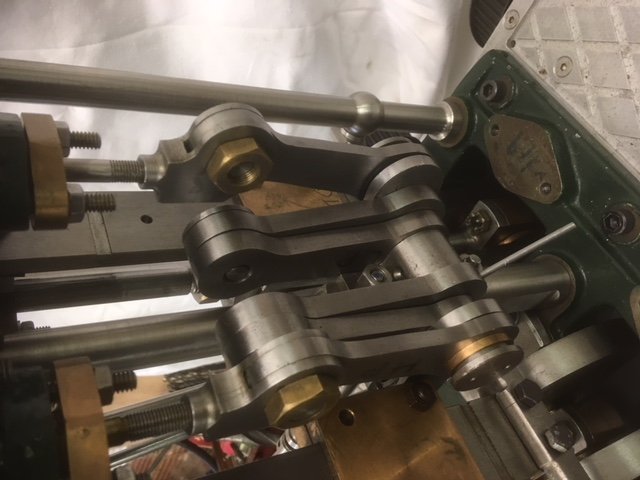

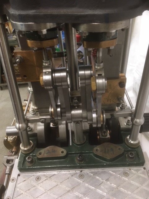

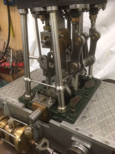

I have taken some photographs of the engine to show you were I have got to. I have reassembled it with the parts that I have but there are questions remaining. For example there are tapped holes in the baseplate in two flanges but there is nothing to fit there.
It seems that I can only attach 3 photos. Is this right or am I doing something wrong?

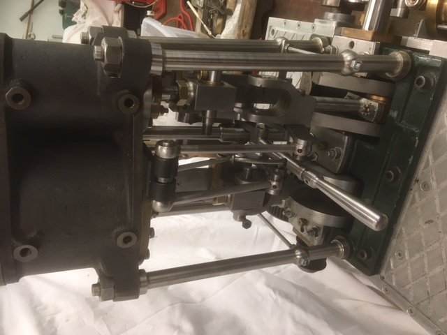

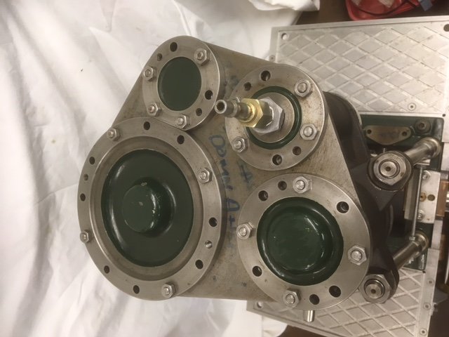

Re: Gordon Cheape Compound
Here are a couple more. You can see that the steam is connected to the top of the high pressure piston valve which I find unusual but is as Gordon Cheape drew it. I have not tried to run the engine yet as the parts are only loosely connected but the previous owner said that it owner dais that it did 3/4 of a turn and locked up and the when the valve gear was put into reverse it did 3/4 turn and locked up again.
I have added a couple more photos.

- Posts: 246
This may be teaching grandmothers to suck eggs, but that can be exactly what happens if condensation has not been fully cleared from the cylinders, and some engines require several goes in forward and reverse gear alternately with the drain cocks open before they will run properly. With other engines, warming through with the drain cocks open is enough to blow condensation water out of the cylinders, but it doesn't always work that way.
I can't actually see any drain cocks at all, but that may be my eyes and the way the photographs are taken. The engine certainly needs them.
It has only been run on compressed air so far. There are 4 tapped holes in the cylinders and I have just ordered 4 pressure gauges to fit in these to give me a clue as to what is happening.
Hi Martyn,
Best Dietrich
because your engine has piston valves you need drain cocks. In the tapped holes you have to mount the drain cocks. If you fit there pressure gauges you could destroy them.There are 4 tapped holes in the cylinders and I have just ordered 4 pressure gauges to fit in these to give me a clue as to what is happening.
