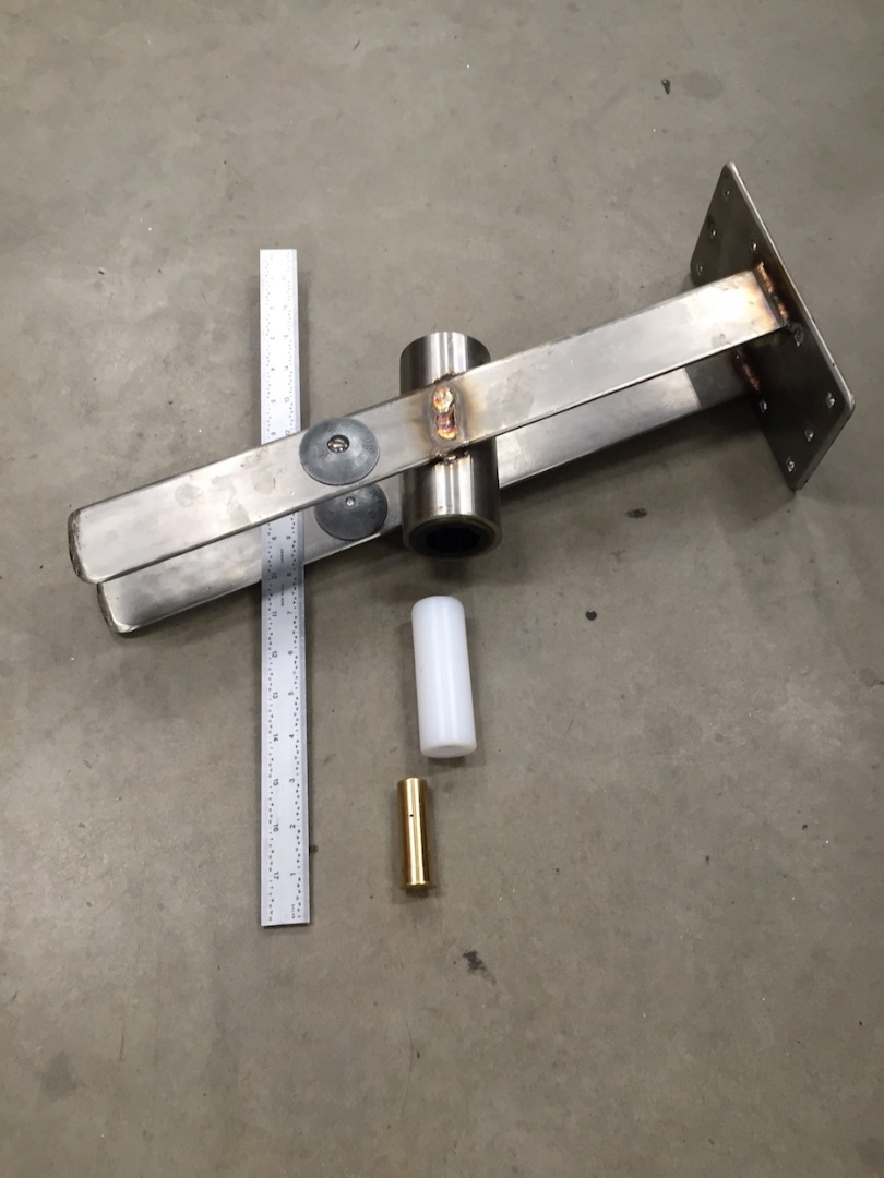

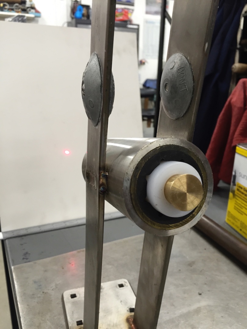

I machined a sleeve to hold a laser gun-sight alignment tool, centered in the Cutlass bearing.
ST Cutlass Bearing 1 sml.jpg (183.79 KiB) Viewed 19896 times
ST Cutlass Bearing laser sml.jpg (172.71 KiB) Viewed 19896 times

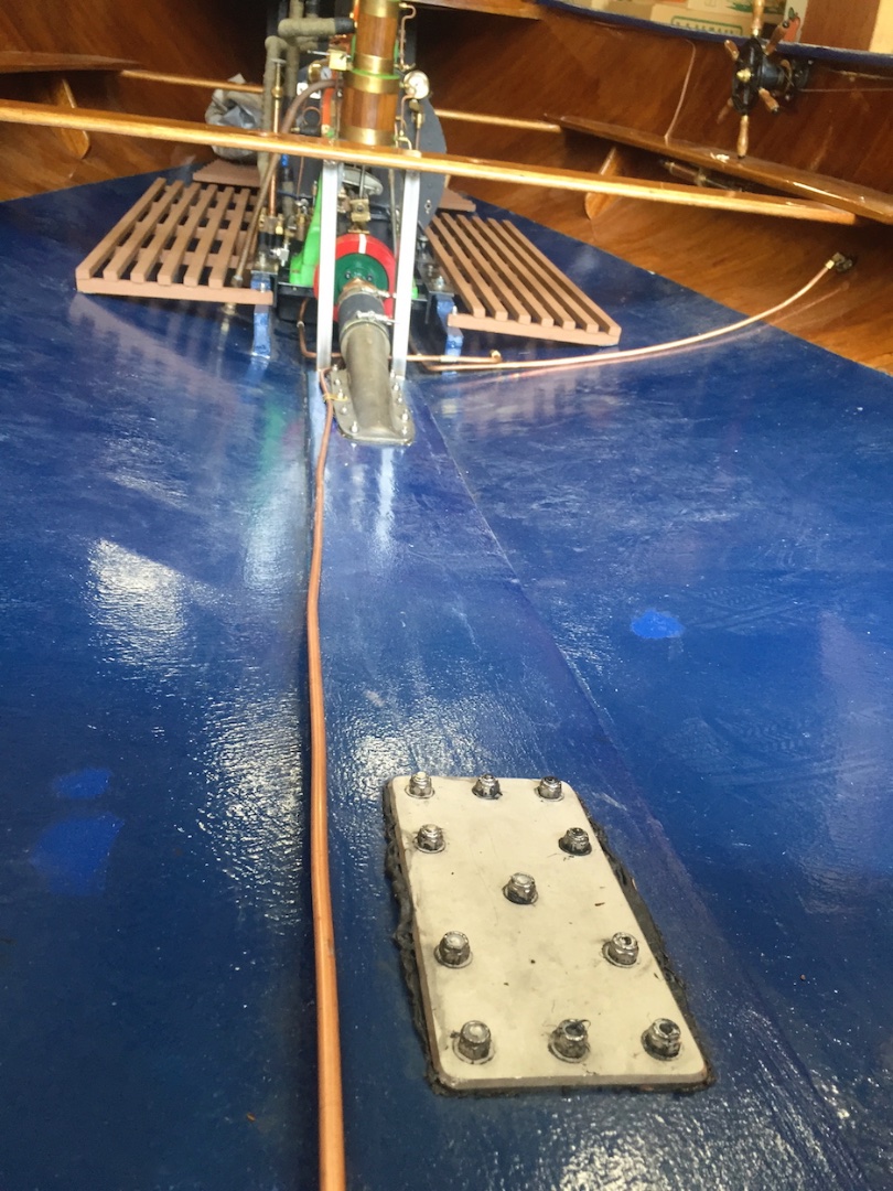

My Good Wife and I installed the Cutlass bearing and support using 11 stainless through-hull bolts into the upper stainless steel plate.
Continued on next entry.

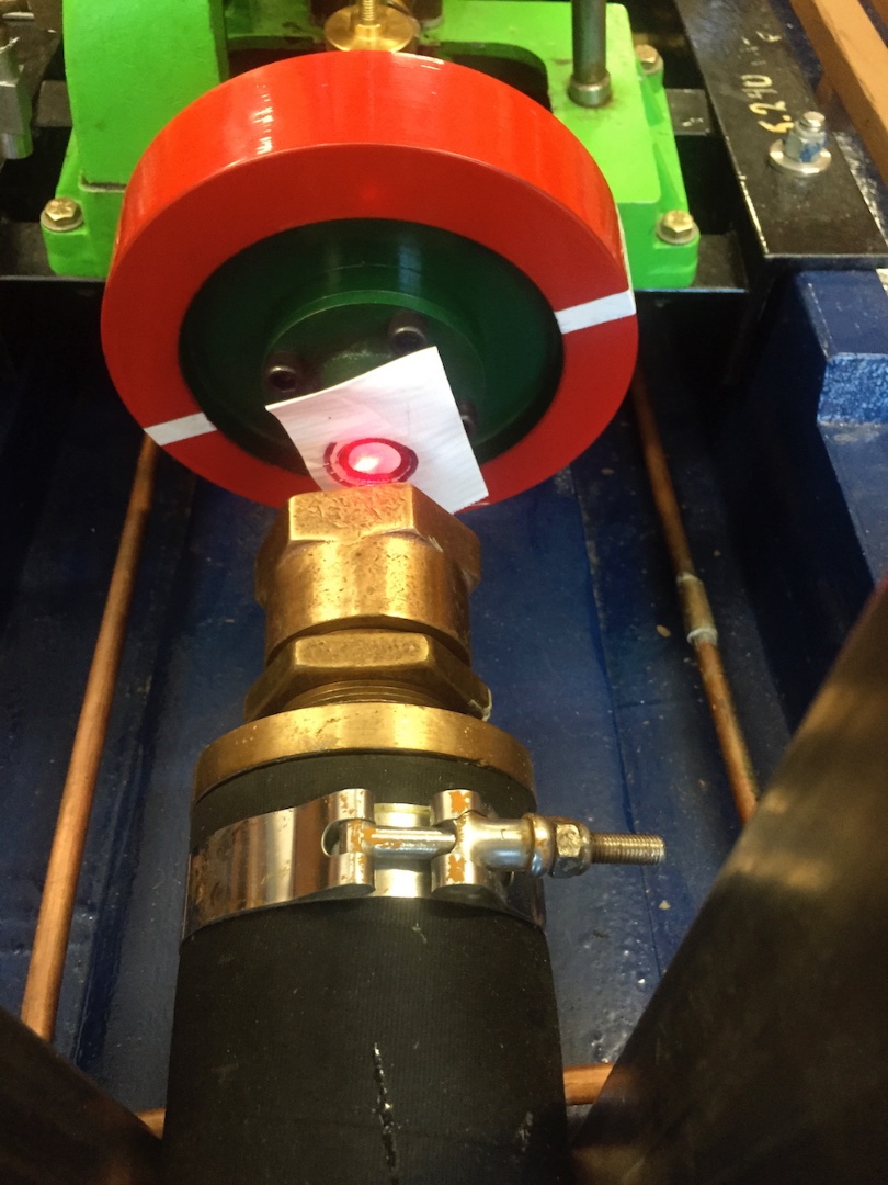

I drew a target on a piece of white tape, placed over the opening of the flywheel shaft receptacle.
The laser shined through the shaft log onto the target. By tightening the 11 bolts properly, I aligned the laser onto the center of the target.
Alignment achieved! Picture while I was aligning the bearing support.

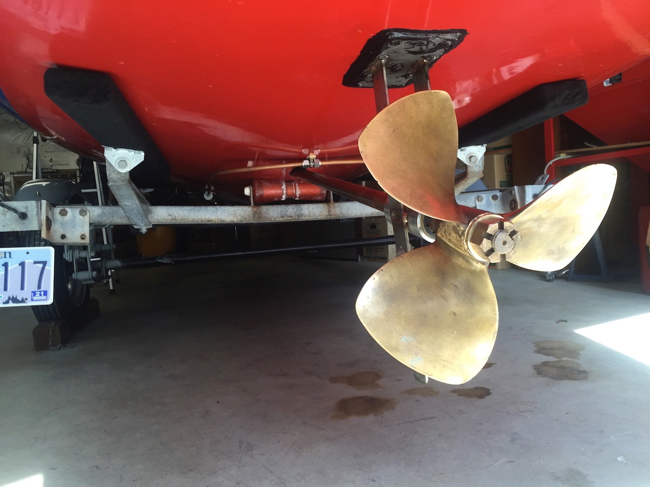

Then I removed the laser setup and slid the shaft into position through the Cutlass bearing. Easily done with the alignment correct.

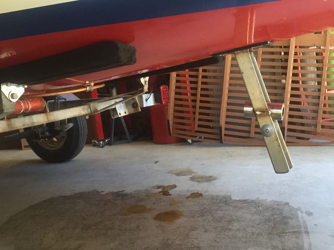

Picture of the Cutlass bearing upper support plate.
It now happily blows air when the engine is running. :D
I have since installed the floor boards, too.

Lining up engine and prop shaft accurately is obviously a nice thing to do, and congratulations on doing it. However, having suffered seriously from the effect several decades ago, I have to rather reluctantly point out that all hulls distort when put into water, particularly normal open launch hulls, and that distortion depends on loading, and will increase if the launch ever sees waves of any size - even the wash from another boat. Again reluctantly, I have to say that a slightly flexible coupling between engine and main prop shaft is very desirable, though in many cases there is enough flexibility in the prop shaft and its supports to give the same effect.
Posts: 266
Re: Searching for my Steamboat's History
RGSP:
I agree with your observations about hull and shaft flexibility.
That was quite apparent when I observed that I could change the position of the red laser alignment dot simply by changing the position of my feet in the hull.
The hull is also a thin cold-molded wood structure, so I do expect alignment changes during steaming.
This hull and engine were in service for several decades without observable damage to the hull or engine bearings.
So I am assuming it should continue to be OK when steaming.
I expect I will wear out before this steam launch does!
I contemplated a flex-coupling between the engine flywheel and the shaft. It remains a possibility, to be defined with steaming experience.
Thank you for sharing your observations.

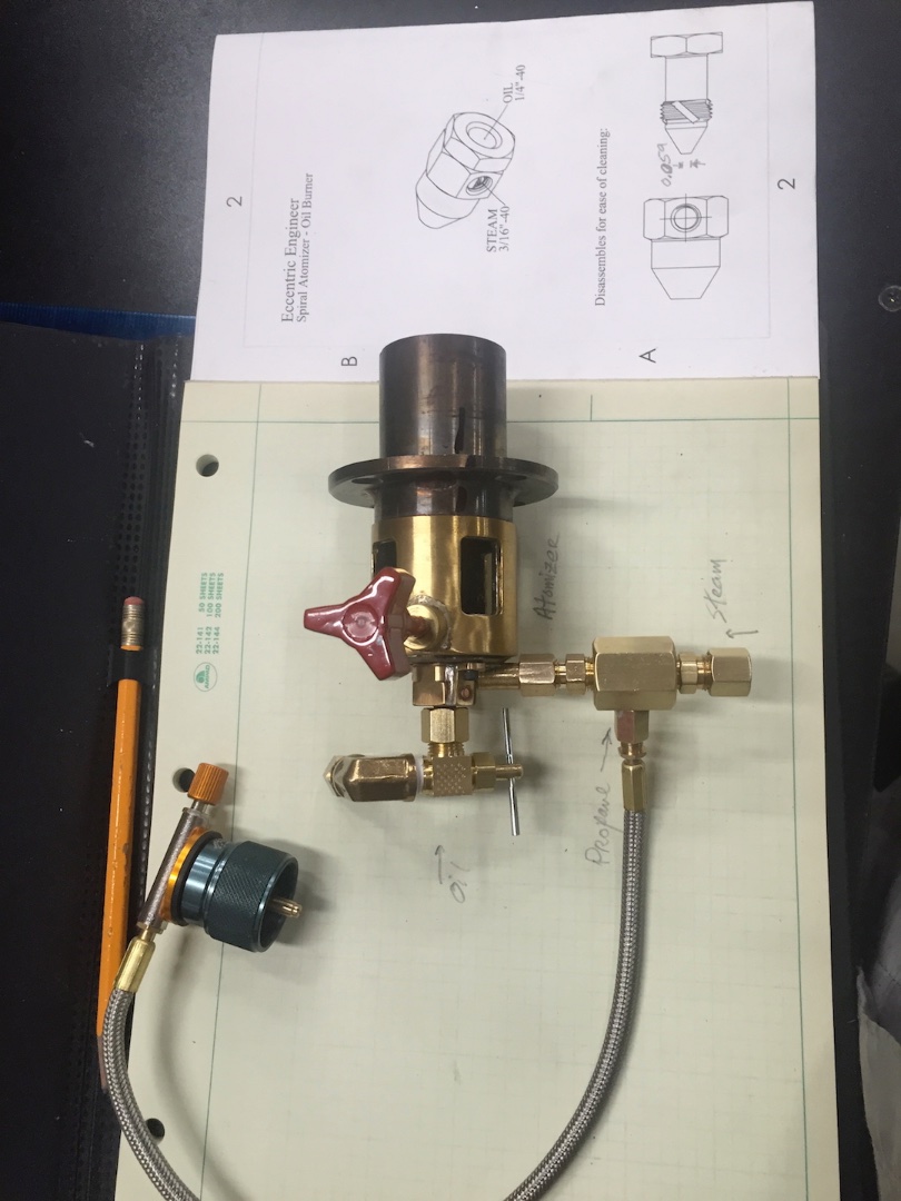

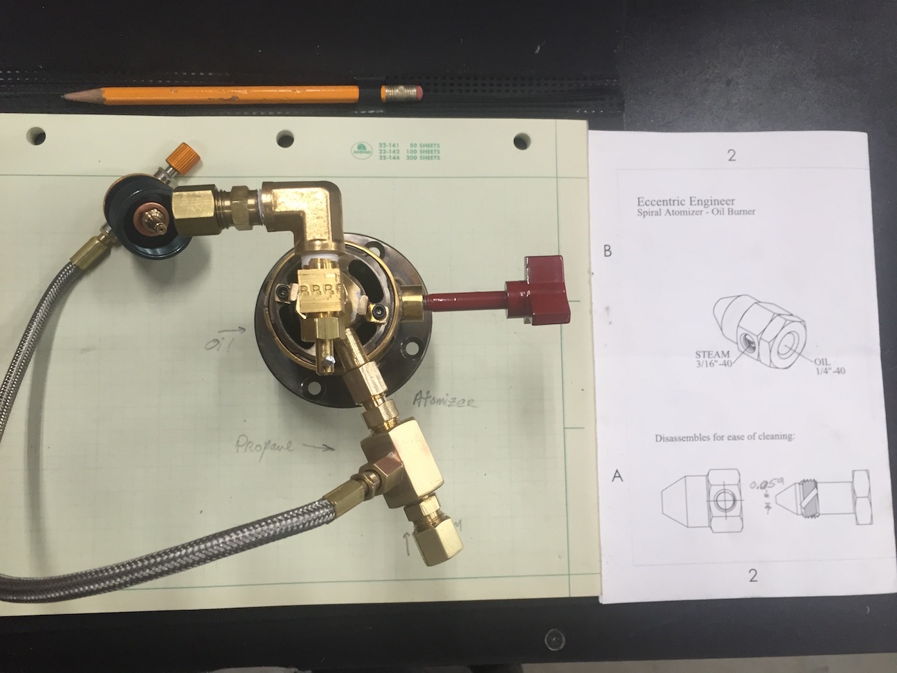

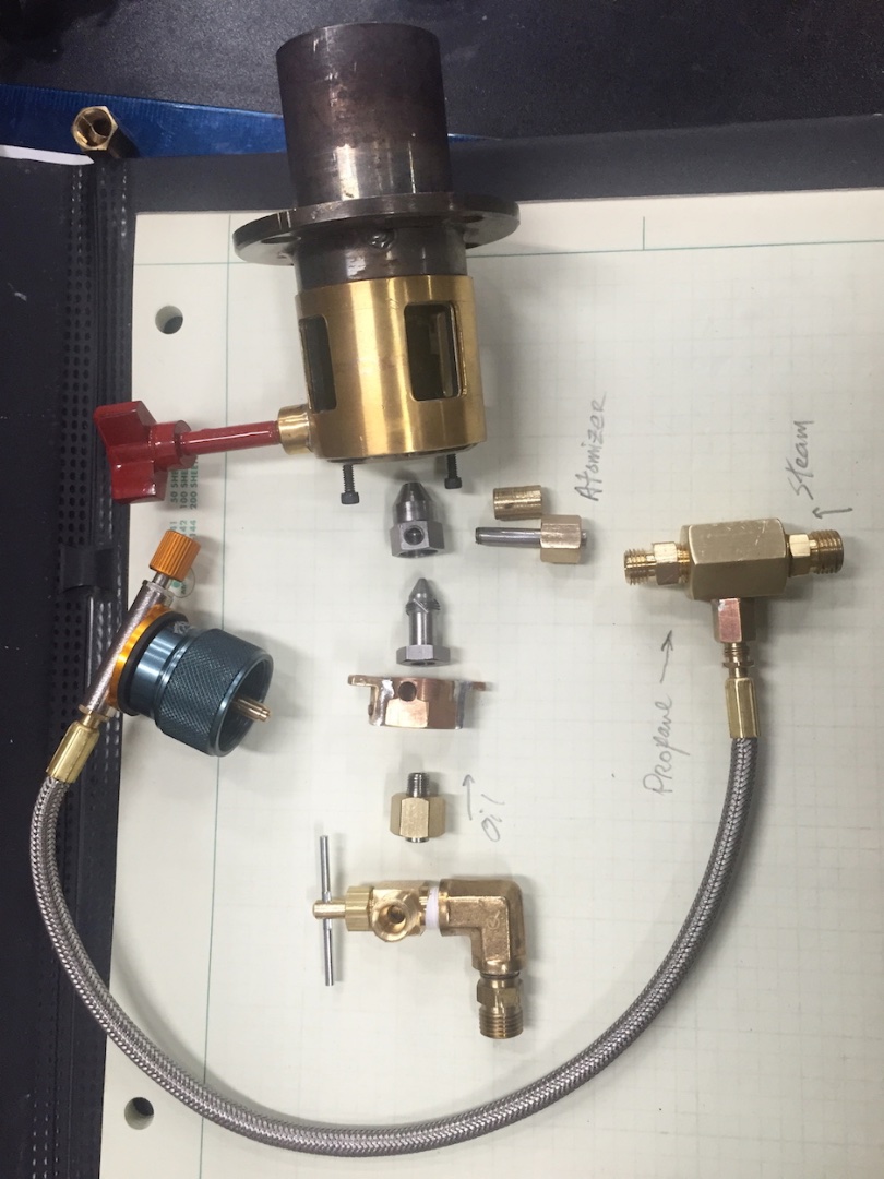

I designed and fabricated an oil burner, centered around the commercial burner CNC machined by Eccentric Engineer in California.
https://www.eccentricengineer.com
He is a fabulous producer of injectors in several sizes. Food for thought. The burner he offered is out of stock at this time.
It was designed for use in steam locomotives of larger size (1/8 scale +.) Contact him if you want one!
It produces a nice well-atomized ball of flame similar in volume to a football (Not the US kind). Perfect for my Blackstaffe-style boiler.
In the pics posted below you can see the drawing of the two-part burner with it's slots producing a tornado output to atomize the oil.
I needed to make a way to hold the burner to utilize it for my boiler.
I also set it up to use propane to atomize the oil until steam is available. It seems to work quite well on the test bench!
Burner 2 sml.jpg (182.28 KiB) Viewed 19559 times
