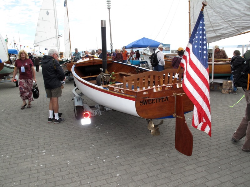

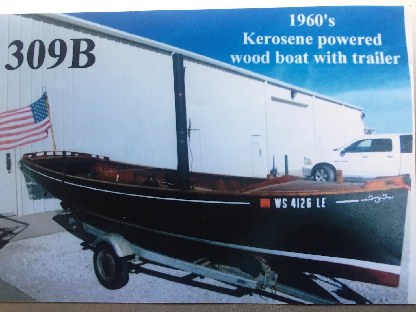

The boat was sold at auction in Wisconsin in 2016-ish. (See the auction picture below, with its black hull.)
It was purchased by Bill Palsoulich of Port Ludlow, Washington State.

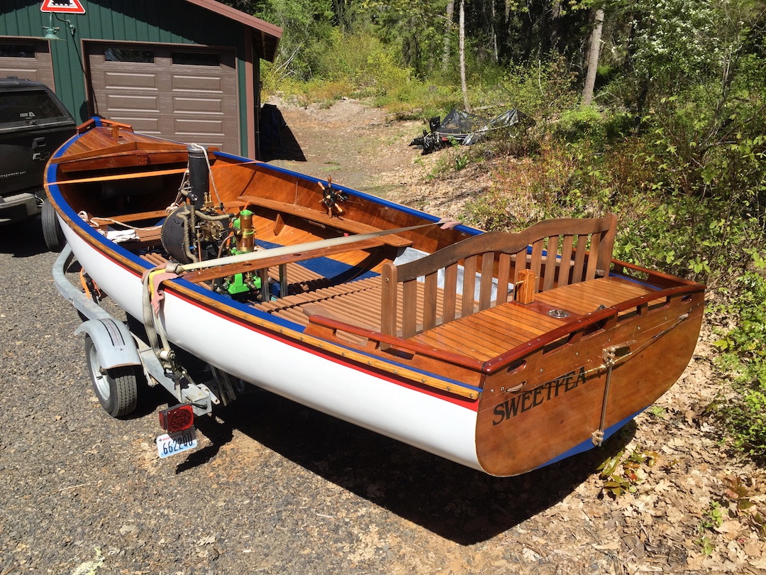

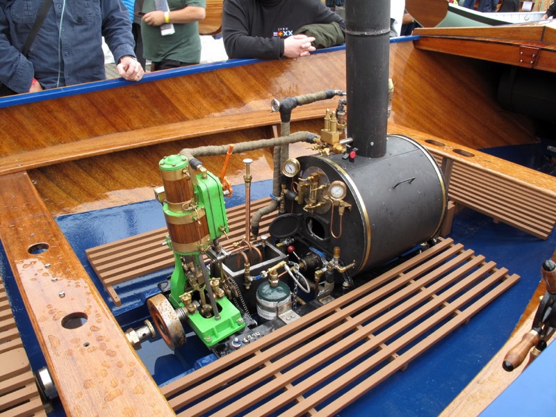

Some more pictures of my Steam Thistle.
~Russ Noe`

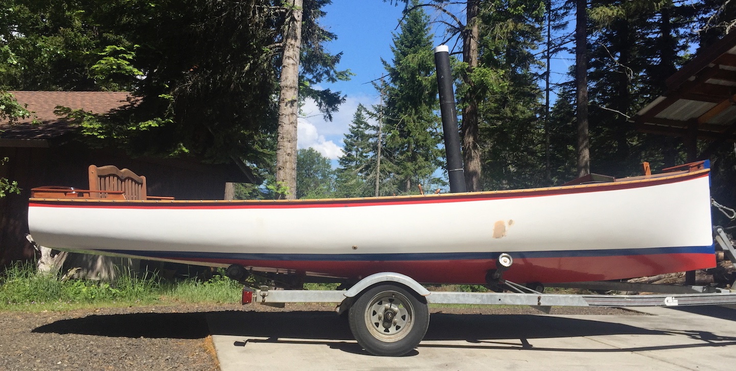

Progress Report:
As my rebuilt right shoulder has come back on line, I've begun working on the Steam Thistle. Now I know I can use an impact wrench left handed...

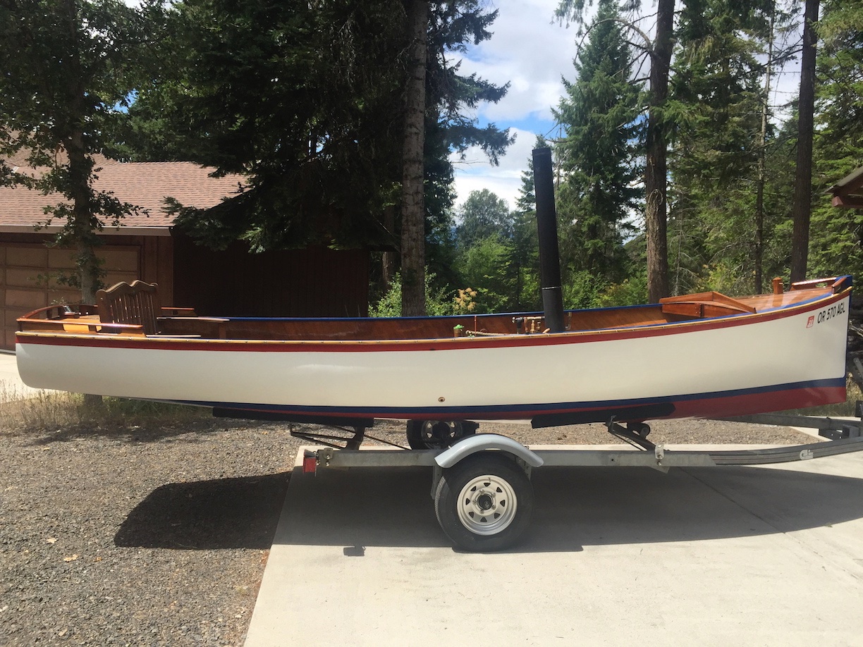

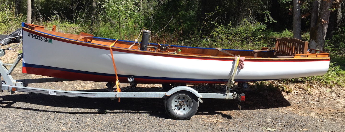

First picture shows the trailer and boat as received; second picture shows the boat on the rebuilt trailer.
New suspension to lift the transom off the road (gained 9" of height!), new tires, new robust fender mount system, new bunks under the wooden hull, new license and more.
May not seem like much, but I have to approach this project literally from the ground up. And now I can re-install the prop, shaft, and aft bearing support.
I've also designed and fabricated the missing bilge water ejector, and am working on the steam atomized oil fuel burner system. Many such items disappeared between the time of the restorer's passing, and when I acquire this project steam launch.
Also repaired the small patch on the starboard outside of the hull (matched the paint!), and have done all the required varnish touchup. Love that smell!

Second picture, showing rebuilt trailer.
Russ

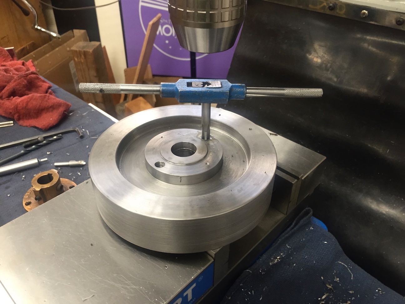

Re: Searching for my Steamboat's History

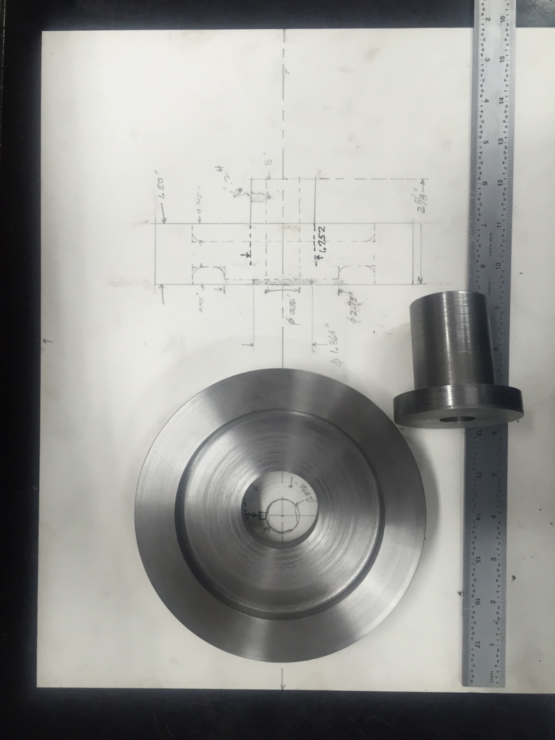

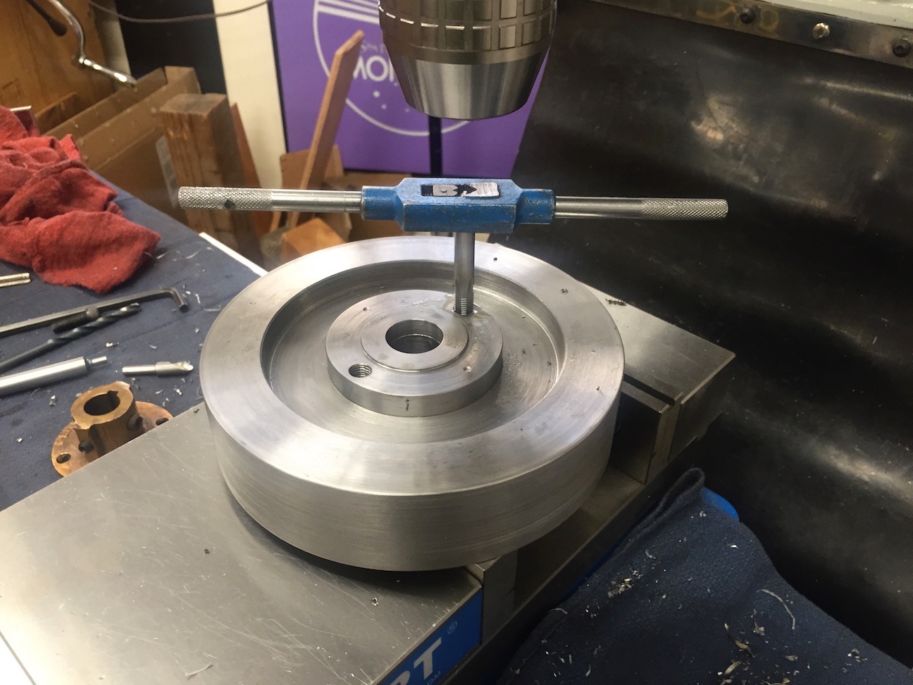

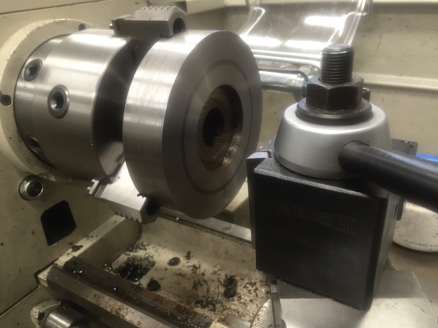

I finished and installed the replacement flywheel.
The original cast unit was unfortunately missing, and is visible in an earlier picture in this thread.
6" diameter and 11 lbs. (15.24 cm and 5 kgs)
The new flywheel is machined from two steel parts pressed together. It came out very nicely.
B-Flywheel 3 small.jpg (149.74 KiB) Viewed 48986 times

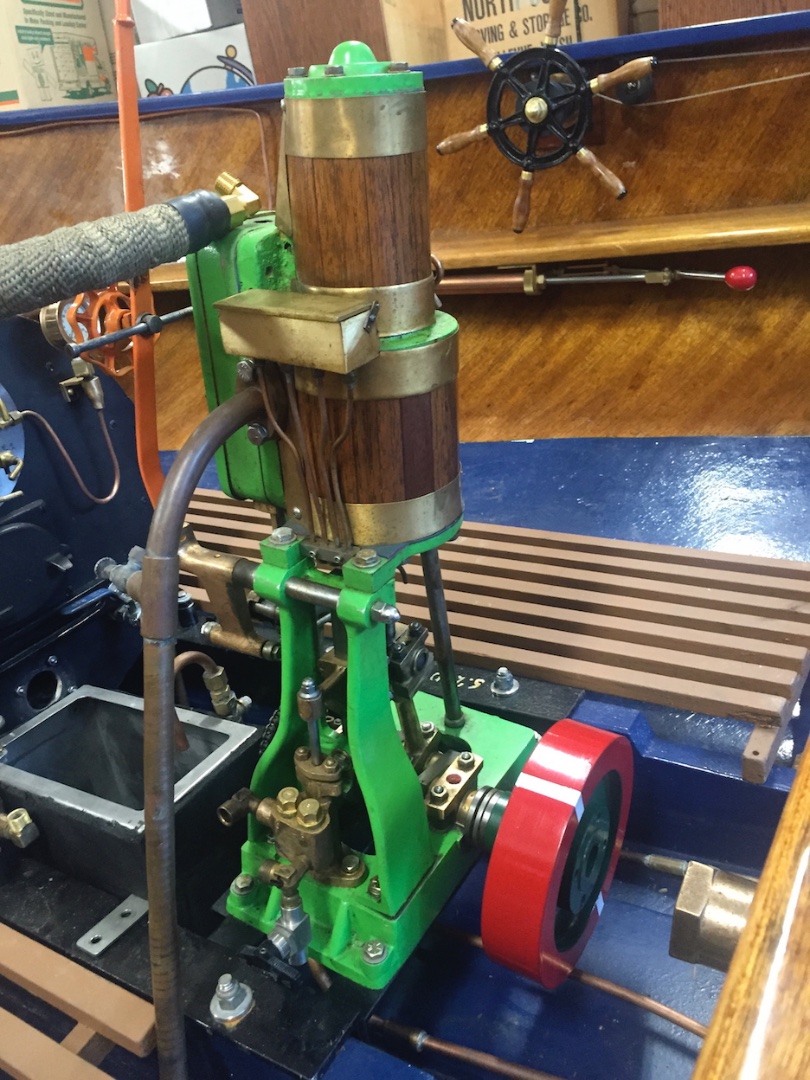

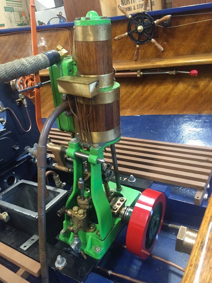

Finally installed the new flywheel on the engine.
I painted two white stripes on the rim so I could determine RPM using my hand held optical indicator, from my RC aircraft flying days.
So I've been able to test the engine using compressed air, and it runs perfectly. Yea!
