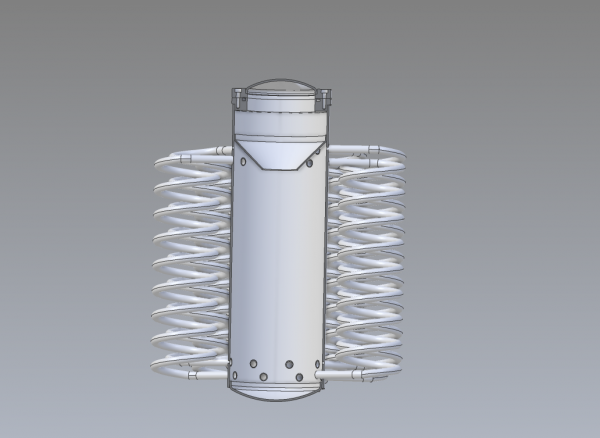

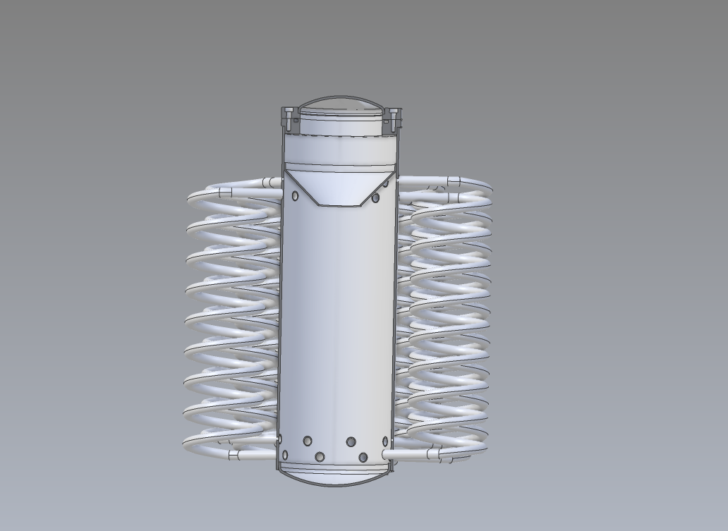

that's how I thought it would be. The cap is removable for cleaning and inspection.
I will collect a lot of ideas before I actually build the boiler. For the first the tubes will be rebent.

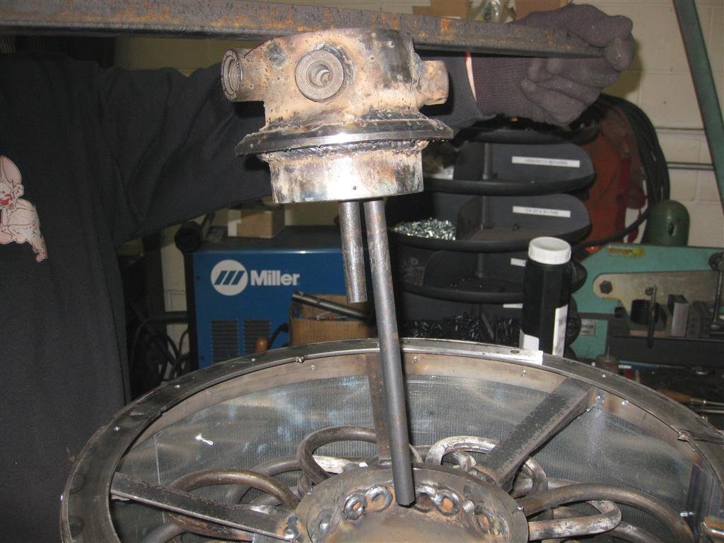

This is how I did mine: I added a steam dome of sorts and let it protrude down in the centerdrum and it extends below where the generating coils exit. So the upper steam head is really a ring shape. This boiler with a 300 thousand BTU kerosene burner will make steam from cold in about one minute.

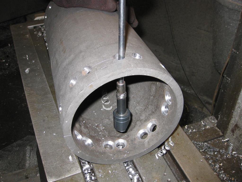

This is how I chamfer bevel holes on inside for welding. That is a single flute chamfer countersink tool welded to an old wrench socket, then the extension is put in an electric drill.
Also, Three different types of welding were used MIG. TIG and ARC. The ARC welder worked the best with good quality (Pro-line? I think) 7018 rods electrodes. All ARC welded joints were sealed and required no repair.
Another thing to keep in mind, any joints exposed to water, should be butted together with out a space in between. This is what causes rolled in tubes to leak over time, water lays in between and corrodes the steel. This is in line with welded steel boat hull fabrication, they use no lap joints, or shouldn't anyway.

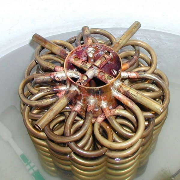

I will built a pipe cross from 1/2" gunmetal nipples like this (my little experimental boiler) for steam exhaust.
The data of yours are very impressive, i will run my only with 7,5 bar (105 psi). Which valves and controls have you installed?
