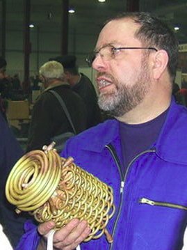

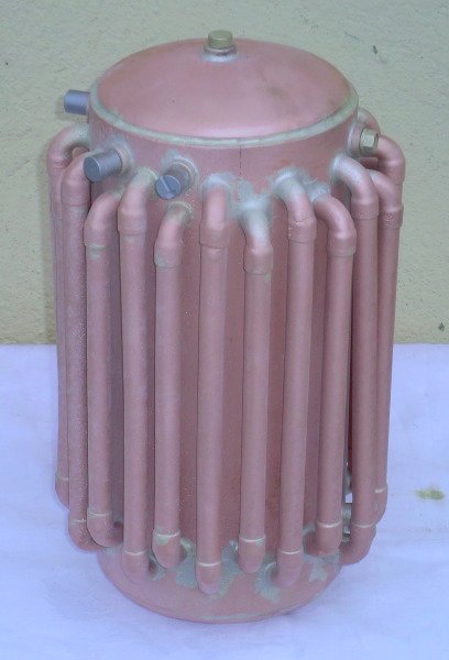

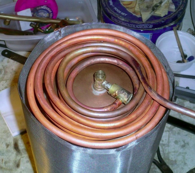

I built a small OFELDT for experiments in 2007 - I call it LOCKENWICKLER (Men need a name four her toys) - and an other LIFU with a very mighty overheater for a 7 1/4" Clishay.
The experimental OFELDT-Boiler "LOCKENWICKLER"

The LIFU-Boiler "Seegurke" (sea cucumber)
The overheater
The overheater

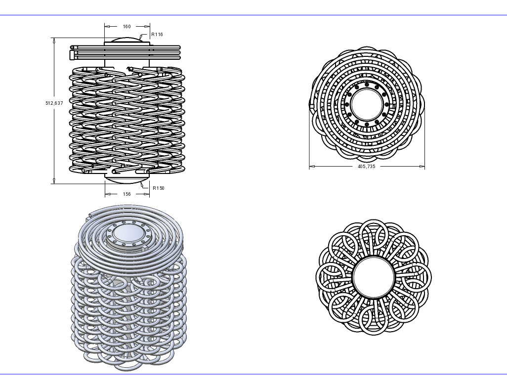

I drew a little and that's the preliminary result.

Your design looks very nice. I think you will be quite pleased with a larger Ofeldt. Natural circulation is wonderful in them... Surely you've experienced how quickly they build steam and with such abundance.

The Ofeldt and Blackstaff are both good boilers which use the same type of coil. The coil is much more beneficial versus the vertical pipe as shown in the one picture. Approximately 5 degrees rise in the water tube it reportedly optimum angle for best natural internal circulation, which the coils inherently have. Reference Derr, Babcock and Wilcox, etc.
Personally I would opt for the Ofeldt, but it really depends on the application, the Blackstaffe can be applied and kept in the same configuration as the Roberts types.
The center drum of the Ofeldt is the Downcomer, it can't be all upwards circulation, what controls that is the difference in temperature, note that downcomers on many boilers are outside the firespace and some even outside the thermal jacketing, the greater the differential in temperature between the downcomer(s) and heated elements, the greater velocity of internal circulation. As Fred states, the burner should be either circular in flame pattern or some sort of deflector should be affixed to the bottom of the drum to limit impinged heat. On the Ofeldt for my Locomobile steam car, we did add outlets in the bottom of the center drum for blow down and water gauge glass, then attached a heat shield under them to prevent boiling and erratic gauge readings.
My opinion is that the Ofeldt was the best boiler design ever concocted. It isn't better in every category, but no other boiler defeats it in all categories nor balance. i.e. considering Cost, weight, labor, pound per hour steam generation versus heated surface area, reserve, footprint, vigorous natural internal circulation, control, etc. It is the best balance of all categories.
