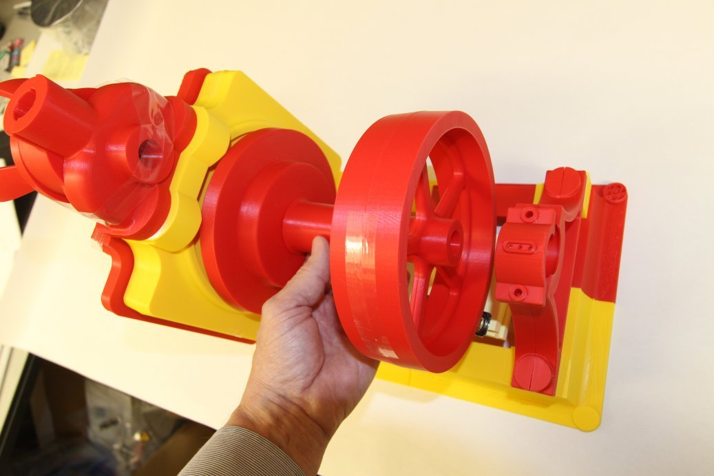

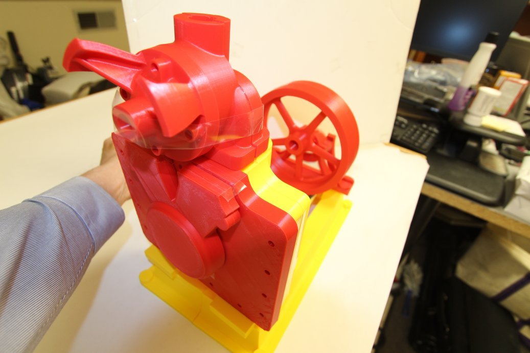

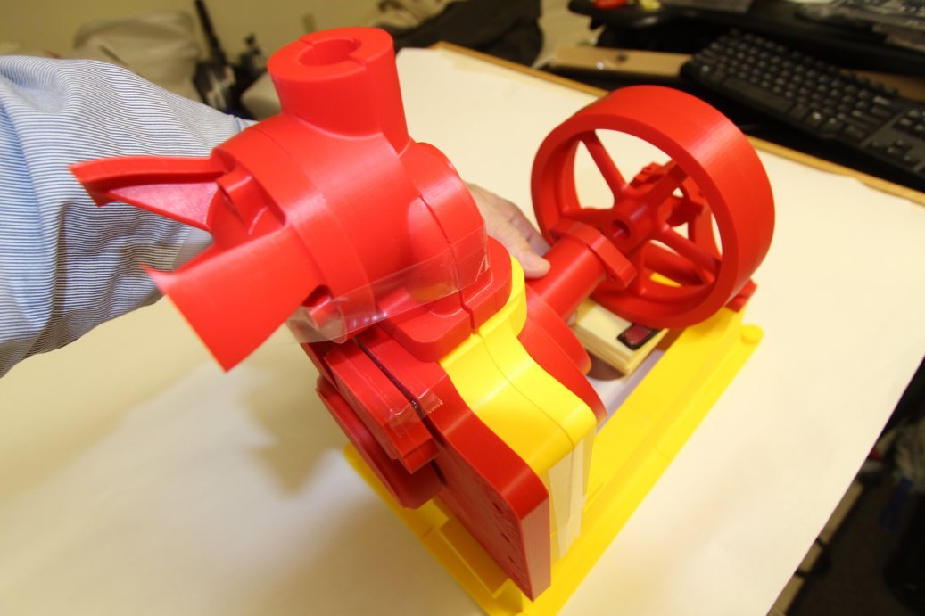

Here is a Dake that I have 3D printed the patterns for.

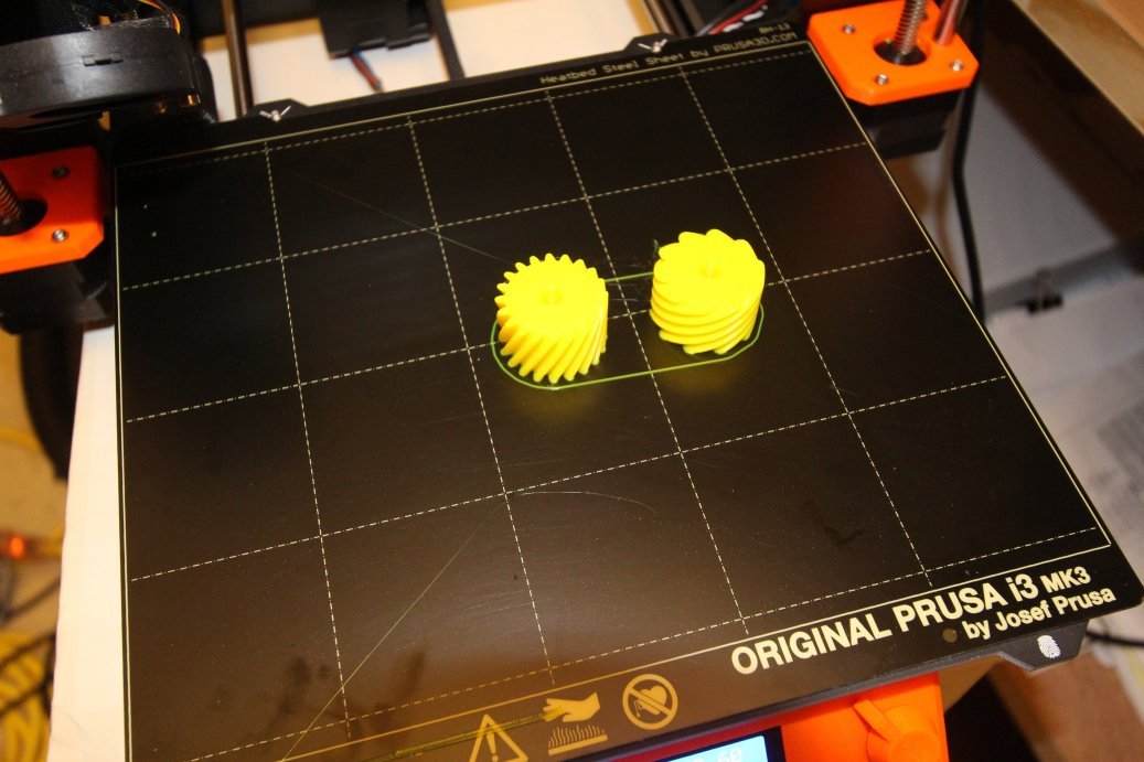

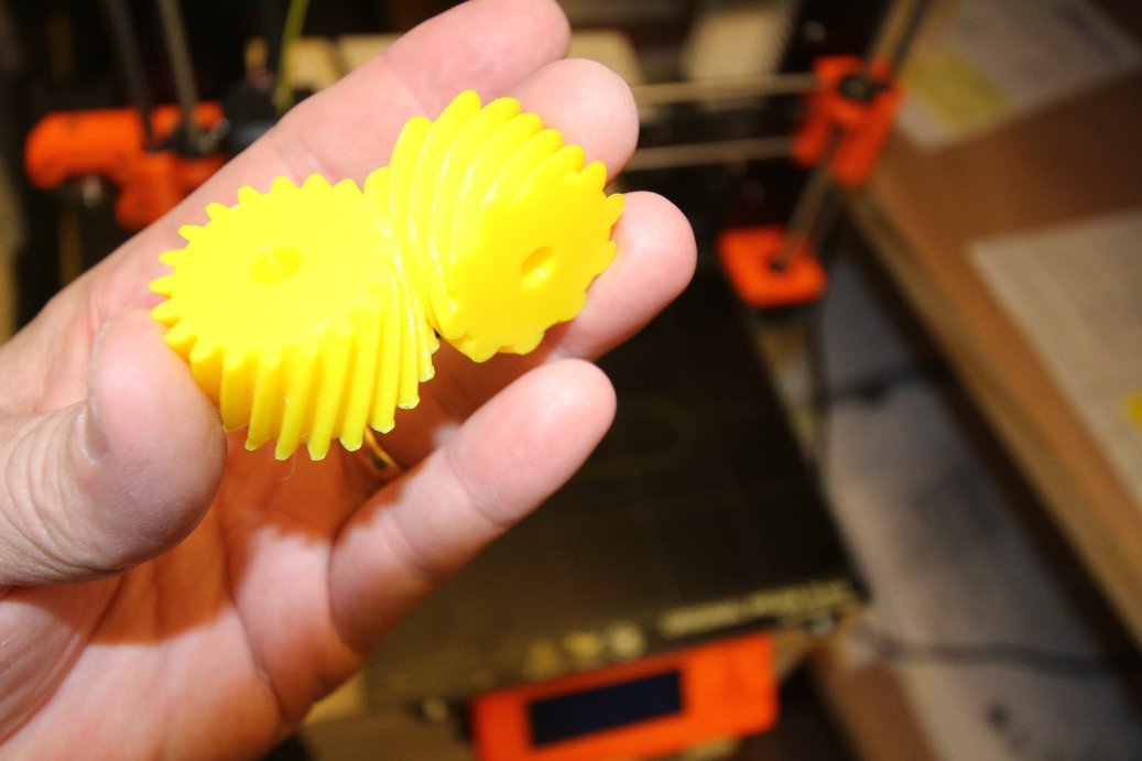

Here are the helical gears I will cast for the 3" bore Frisco Standard.
The are the same diameter, but give a 2:1 ratio, which is a bit of a trick.
