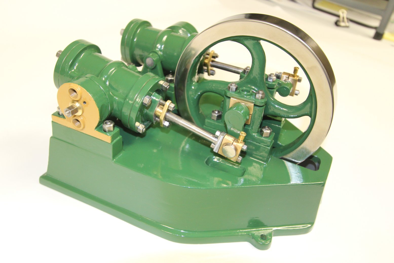

I worked on this engine since 2012, and was beginning to think I would never complete it.
I cast the flywheel in gray iron, and the remaining cast parts in 356 aluminum.
COVID hit and worked slowed down just long enough for me to finish it all.

This is the first complete steam engine I have made.
All derived from 3 photos that a buddy of mine found on Preston's Services steam engine website in the UK.
What a journey it was, but boy did I learn a lot.
I can cast gray iron parts with impunity now, defect free, accurately cast, and easily machinable.

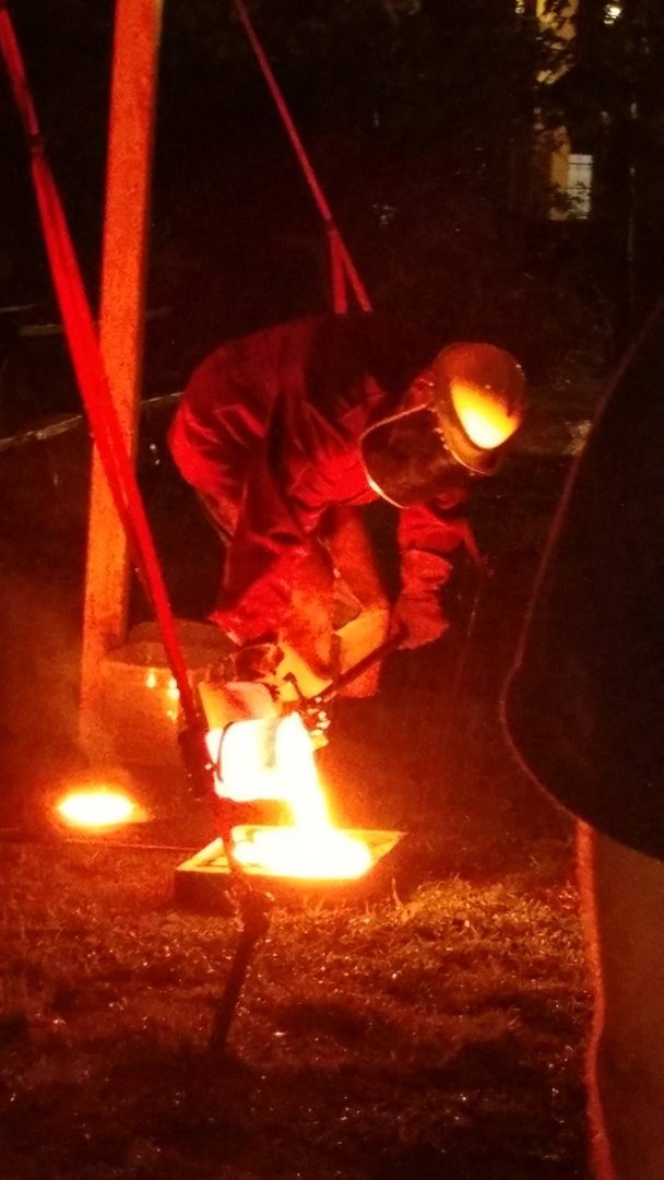

Pouring some gray iron.
It takes a lot of leather to pour iron, since the radian heat is significant.

Nice job! What bore and stroke?

Thanks.
Bore is 1.25", stroke is 2.0".

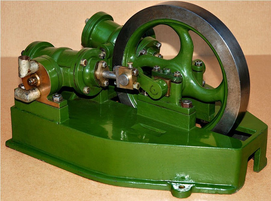

Here is a photo of the original engine that was on the Preston's Services site in the UK.
My engine is 60% of the original.
I got it as close as I could get it, but only had three photos, and I think they were all from skewed angles, so tricky to get it exact.

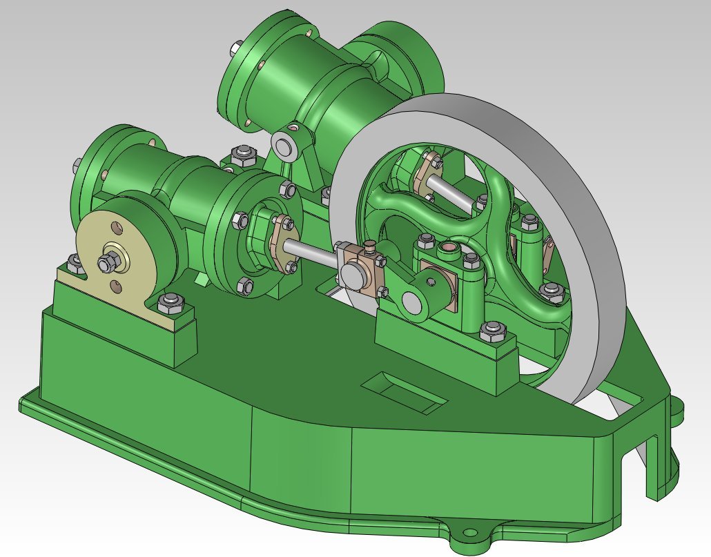

Here is the 3D model that I made.
Many of the patterns were 3D printed from the 3D model, including the flywheel.

That's quite a useful size, somewhere in the 0.75HP range at 100psi.
