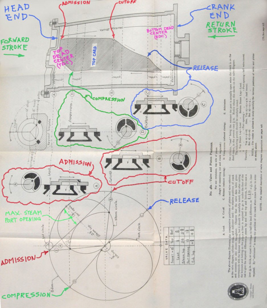

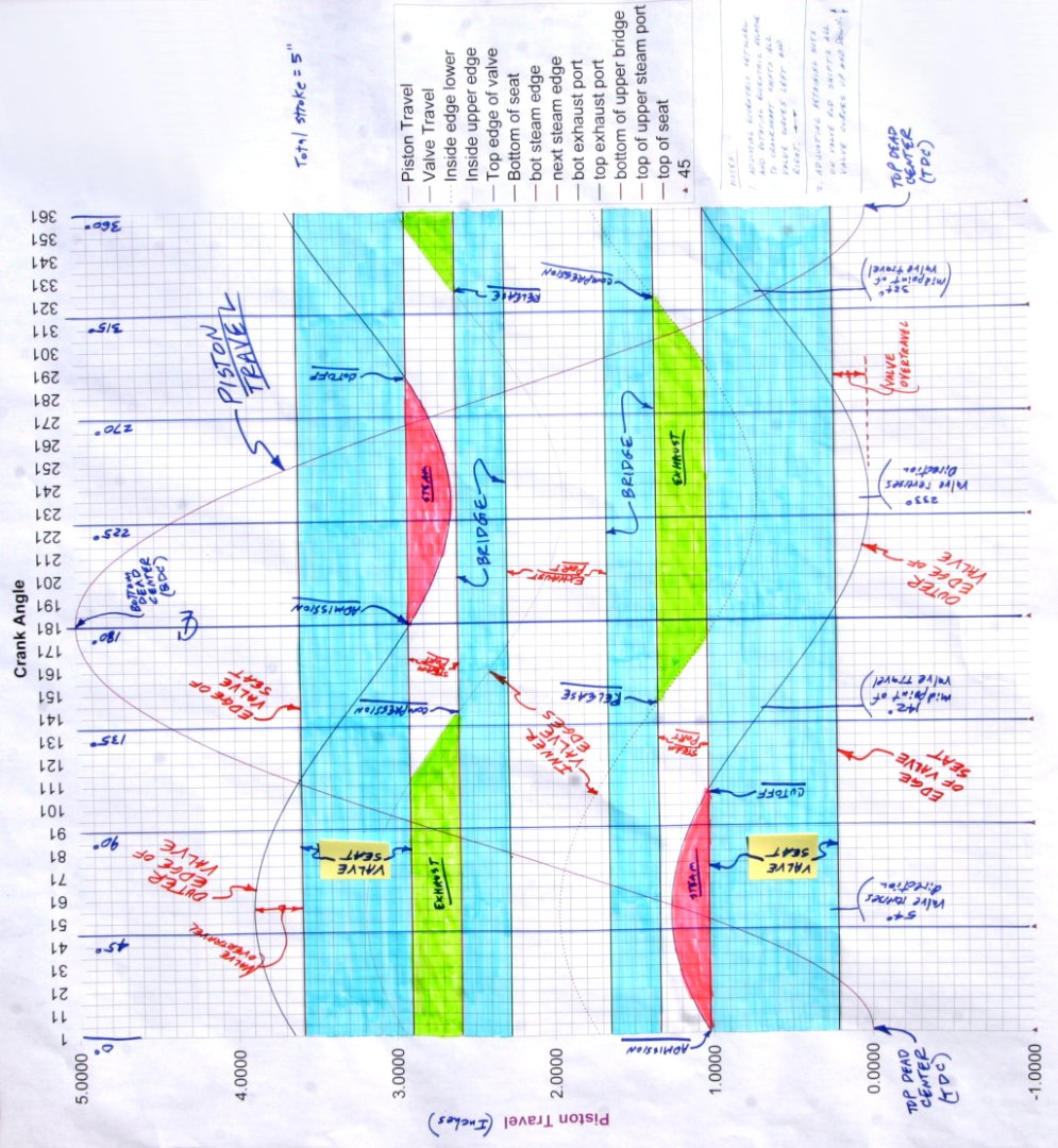

I made this graph in Excel for a Stanley 20hp, but unfortunately I am not far enough along in valvegear understanding to program in the Stephenson's link.
I can't verify that the labels are correct, but they are my understanding of the various points.
I am getting there, but am definitely not there yet as far as valvegear analysis.
I wonder if you could attach linear travel sensors on the piston and valve of an existing engine, and pick off the travel data for various link positions?
Sort of like the indicator.
Also attached is a diagram from Verbal Sketches for Marine Engines, which helped me a lot to understand valve movement vs piston movement.
You can also calculate and plot the acceleration of both the piston and valve.
