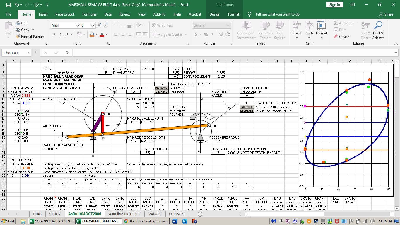

I wrote an EXCEL program that evaluates the Marshall-Bremme motion, every input value that is in a boxed cell can be varied by the user. The valve ellipse, showing admission and exhaust points for both the head end and crank end of the cylinder is presented vs % stroke. The motion graph is based on 360 calculations of one degree each. After messing with mechanism dimensions (god only knows how many times), I was able to arrive at a mechanism that gave virtually even cutoffs throughout the valve forward and reverse notches.
PM me if you would like the EXCEL file, and you can design your own mechanism. In decades past I spent countless hours drawing valve motions on tracing paper, before EXCEL was available, and now one can perform valve dimensional evaluations in one second, which took several hours work in the past. This gives real appreciation to the efforts of 19th century designers who had no computers to solve the quadratic equations necessary to evaluate the valve motions.

Don Aston has done a lot of work with the Stephenson link, and has a spreadsheet.
I am not sure how to attach stuff here, or what format is accepted, but I have these items.
