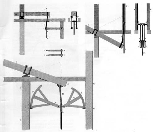

Working on an engine design for a 1790 steamboat (John Fitch, Philadelphia PA, USA), I came across a James Watt Patent for his straight line mechanisms. The difficulty of getting a steam engine piston rod to move in a straight line was a serious challenge in the industry at that time.
One of the drawings in the Watt patent shows a "crosshead guide" that is virtually identical to the one on this engine.
