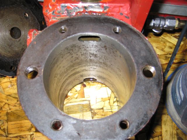

Cool, thanks for the history mtnman! I started tearing down the engine to re-bearing it and ran across a little pitting in the cylinder wall :shock: , so I guess I will be doing a little cylinder work.
Steamboatweek1 010.jpg (63.36 KiB) Viewed 16289 times

bkueber wrote:Cool, thanks for the history mtnman! I started tearing down the engine to re-bearing it and ran across a little pitting in the cylinder wall :shock: , so I guess I will be doing a little cylinder work.
Doesn't look too bad from here. Are you going to bore it out? I've helped repair slide valve seats with JB Weld and imagine it would work on cylinder bores as well. Treat the rust with acid, fill the pits with a light smear of JB Weld, clean up with emery cloth and lap it smooth...or hone in the case of a cylinder. Just presenting an alternative; some people might not trust JB Weld but it has it's uses.

Can't tell from the photo how deep the pitting is but you're not building a F1 race engine.These engines are pretty forgiving so maybe a light honing will fix it Den

as far as the cylinder, put new rings in, and honed the bore, piston seems to slide smoothly, so I am going to let it be.
