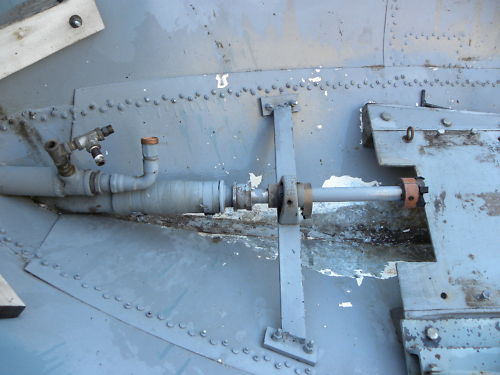

Well I finally jumped in with both feet :D
Tregoning Boat Company, Seattle WA
Built 1940
Galvanized riveted steel
Lifeboat for unknown US Navy Ship
14 feet long
4'8" beam
Prop, Shaft, Rudder already installed

Thanks, I have been conversing with Stan. I found his boat on the NW Steam Soc. website. Those pictures are helpful though, as I do not have any with the canopy close up. I am thinking of moving my boiler more forward of center, as my boat is 2' shorter, and I would like to have the seating togeather in the rear. The only problem is I will probably need a ballast tank if I am running solo. I ordered a 5 hp code boiler from Ronnie at Rappahannock Boat Works. I plan on wood or coal firing. The engine is one I am restoring a 3 by 4 inverted crosshead built without castings.

What engine is in your lifeboat right now? Or is it a Hand cranked shaft? I've seen lifeboats such as yours when I worked at the shipyard, they had six positions for men to crank the shaft. Nice start to a fine project! I also have to ask, where did you find those mountains in the background. I don't remember any mountains in Indiana!

Good eye! that pic was taken when the boat was at it's previous owners place in Colorado :) It currently is sans engine, just a shaft stub beyond the thrust bearing.
