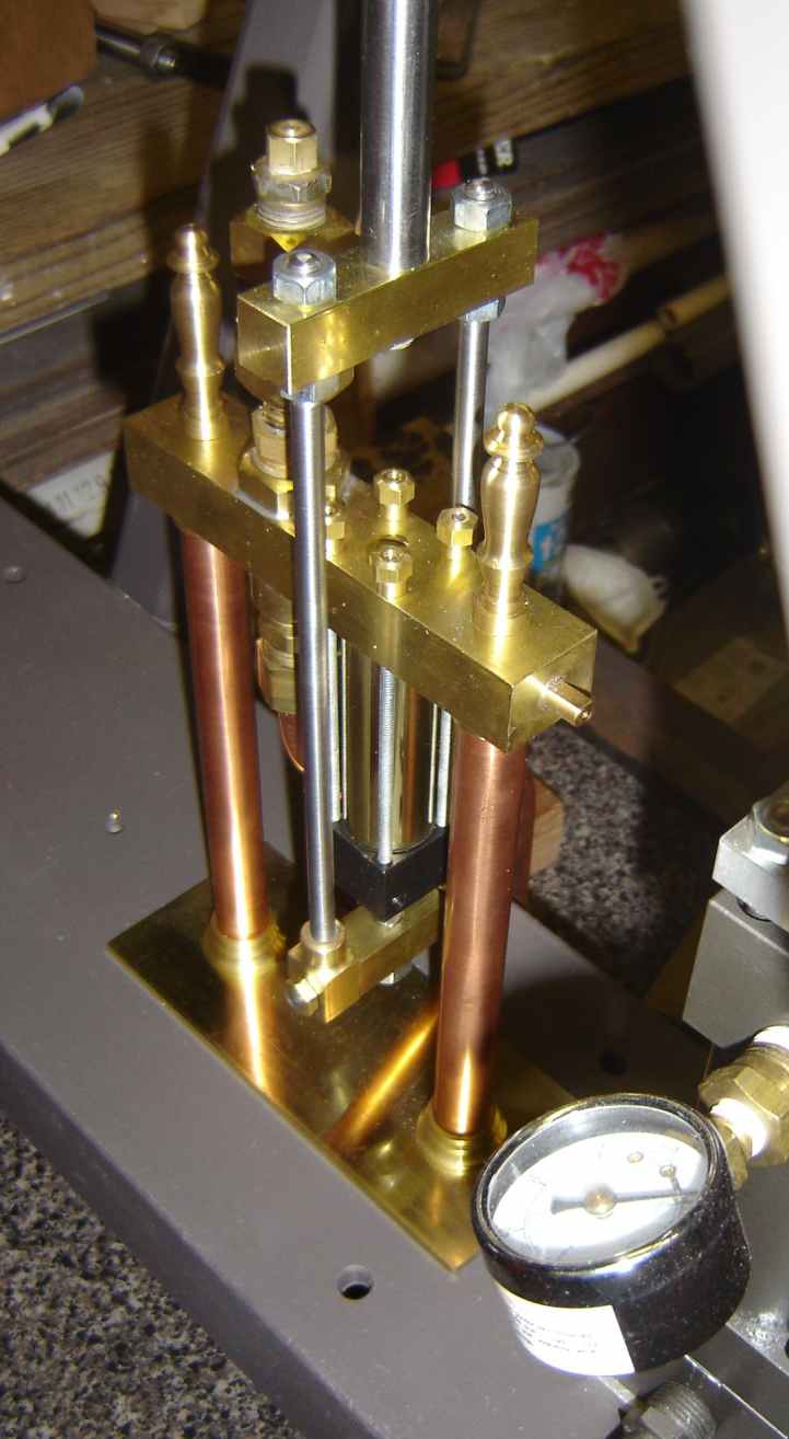

- Feed pump uses 1/2 inch teflon balls, spring loaded, for check valves.
- Beam Engine Feed Pump.jpg (62.66 KiB) Viewed 11537 times
