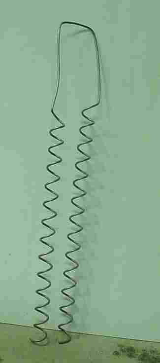

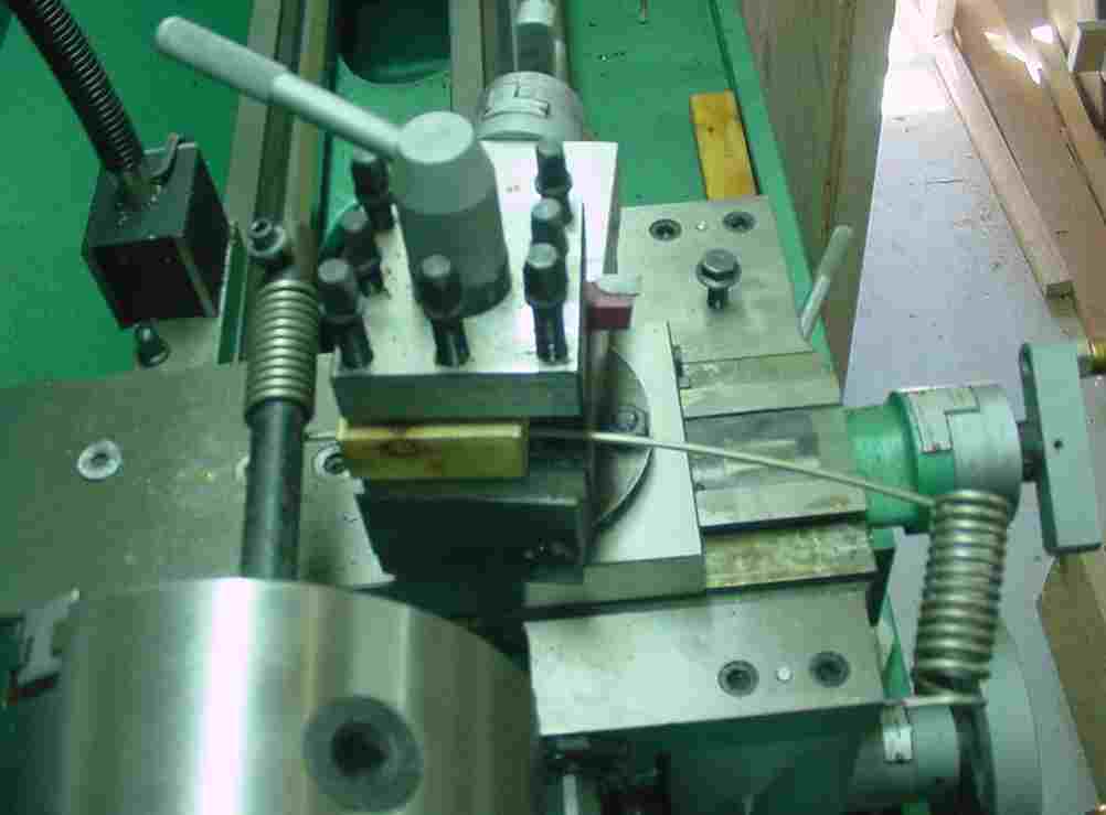

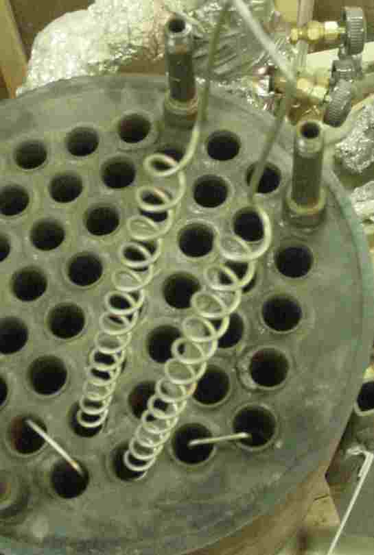

"Adding "turbulators" or "retarders" to the firetubes in my tug boiler as they are 1.5" ID. Is it better to retard the heat all the way up the tube, or should there be no twist in the vane above the water level? To allow the gases to escape more quickly in the non-wet portion of the tube."
ANS: As I am sure you know, in a Vertical Firetube Boiler (VFT), the top section of the tubes will slightly superheat the steam, as this section of the tube is above the water level in the boiler. Most turbulators I have seen are simple "Twisted Tapes" of flat sheet material, and many installations have them through the entire length of the firetube.
However it may be prudent to avoid possibly overheating the top of the tubes by stopping the turbulator at or near the boiler water level. I don't think this is such a problem with metal overheating (although this is a possibility), but more for differential thermal expansion between the boiler shell and the tubes, causing stress on the tube to tubesheet joints. On my sidewheeler VFT boiler I made turbulators of 1/8 inch diameter stainless steel wire, wound on a lathe like a coil spring, with a very loose fit into the firetubes. I stopped the winding in the tube above the water level, this cuts the heat transfer effectiveness on this part of the tube, so it will not run as hot. I am currently propane fired, and the addition of the turbulators cut my fuel consumption in half, quite an improvement.
The attached pictures show how these were arranged.
I will prepare some info on shutdown preferences and the use of copper later, got to get to my day job.

- Winding on lathe, coils streched out later.
- WindingTurbulators.jpg (25.36 KiB) Viewed 25757 times
- Two Wound Turbulators
- WoundTurbulators.jpg (7.22 KiB) Viewed 25757 times
- SS Turbulators inserted into tubesheet of boiler
- TurbIntoFiretube.jpg (19 KiB) Viewed 25757 times
