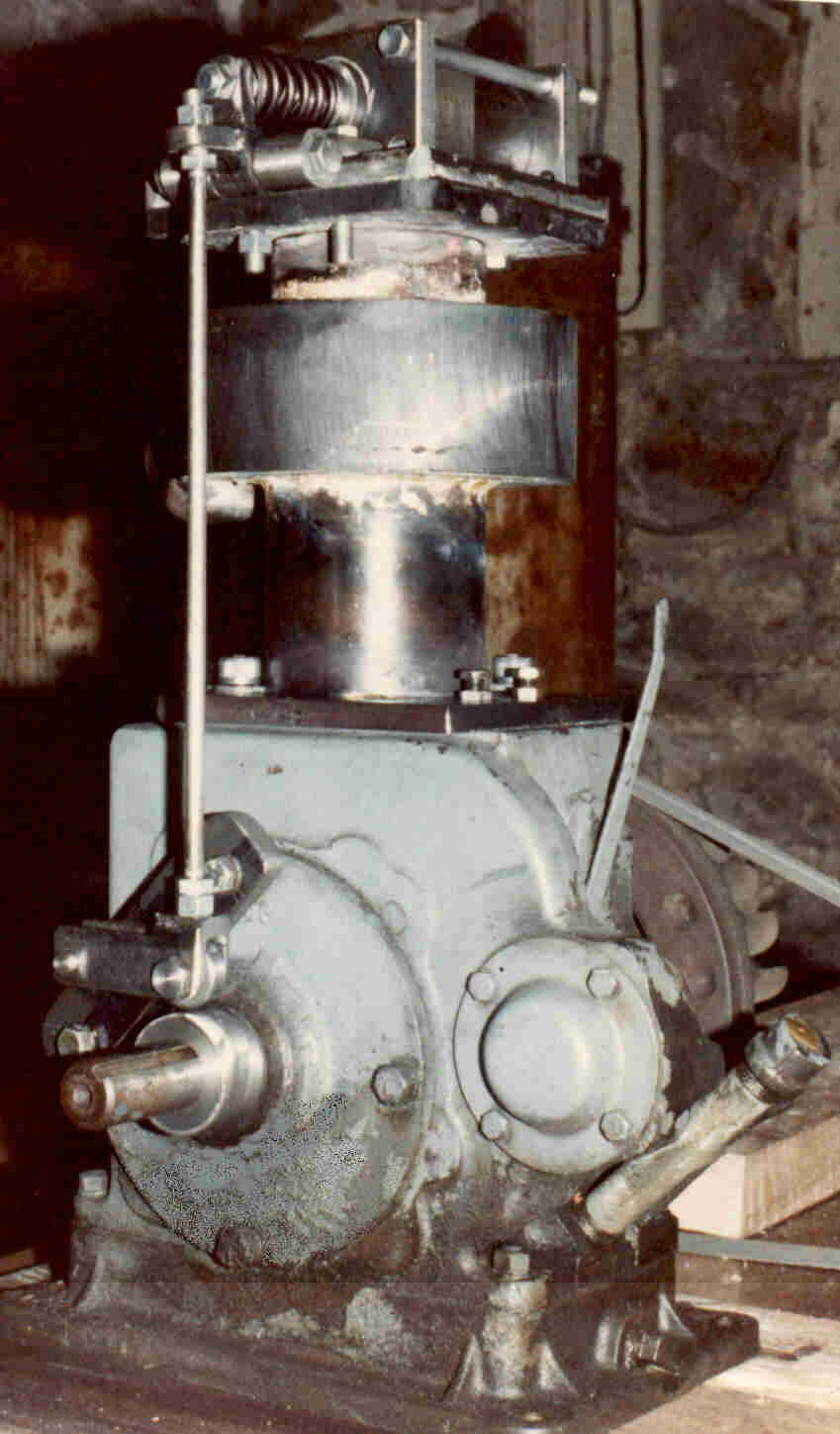

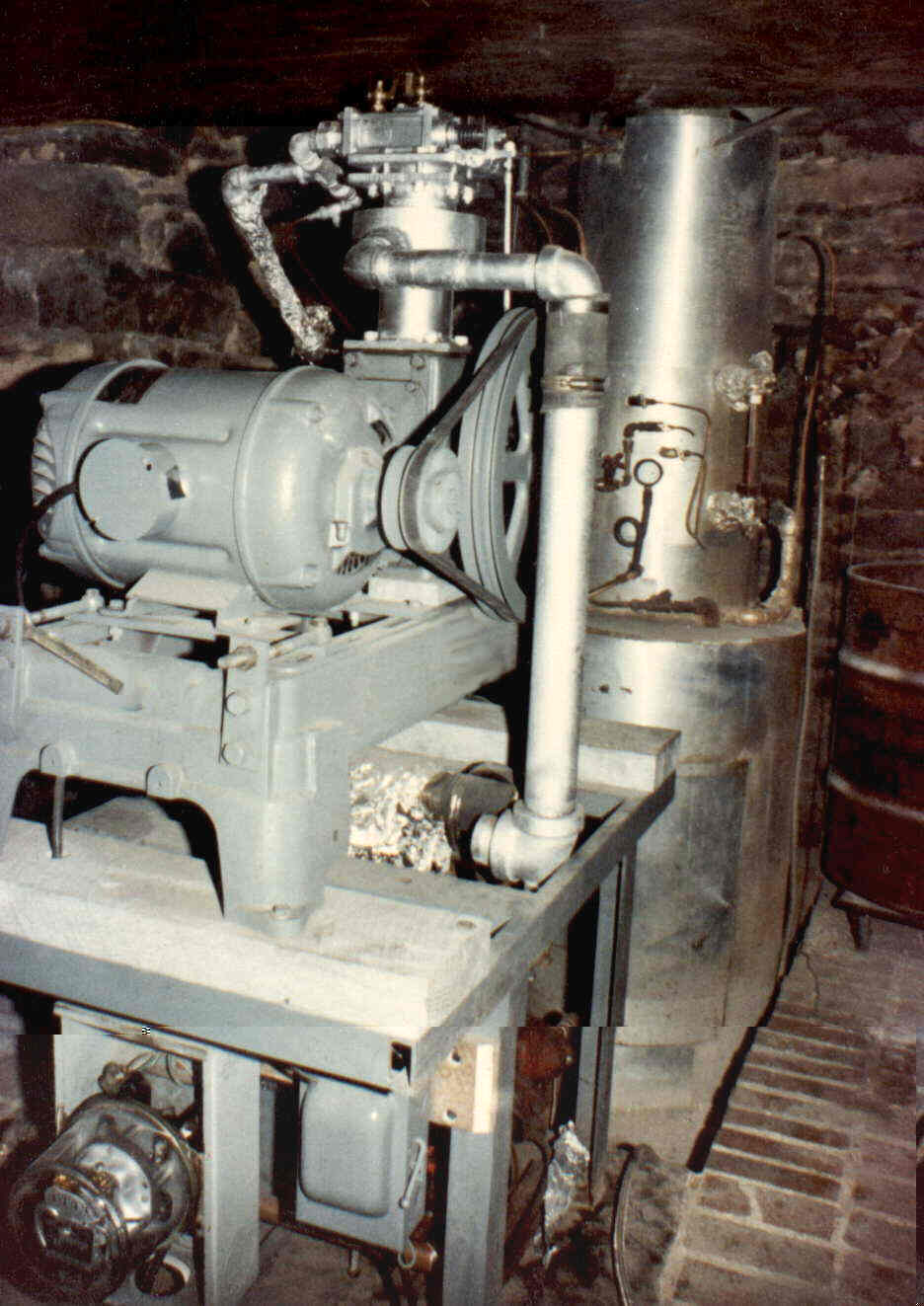

The uniflow engine on my domestic heat-power module had a vent valve on the cylinder, and it would just blow (and waste steam) when starting up. I would think this vent steam could be used to work your ejector and bring up initial vacuum, then be manually shutoff as the normal vacuum pump was up and running. Then this cylinder vent would protect the cylinder from water during startup, as well as facilitating initial vacuum formation at the same time.
When that heat-power module engine was running with exhaust to atmosphere, it sounded just like a four stroke gasoline engine with an open exhaust pipe, unlike any steam engine I had ever heard. Of course, when exhausting to the condenser, the only sound was the valve tappet clearances, as it had mechanical lifters, basically an ordinary IC engine OHV setup working an ordinary IC engine poppet valve in reverse flow (steam supply tends to force the valve shut) for steam admission.
The cylinder was an iron casting, with 18 uniflow exhaust ports 3/8 drilled. The exhaust plenum is a steel weldment, brazed to the iron cylinder. Top and bottom cylinder flanges are also steel, brazed to the iron cylinder.
