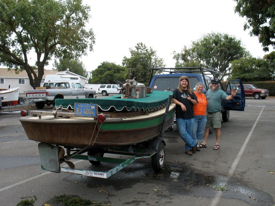

To protect the pipe, you can just make it heavier, or lay it close to the hull. Any thing that will hurt the pipe (aside from perhaps knocks getting on and off the trailer) will destroy a spinning prop, so this is much less of an issue than one might think. I find a set of guides that insure that the boat sits down level on the trailer helps a lot with preventing difficulties at the boat ramp, and forestalling possible damage to the boat; here's a shot of the Otter after recovery at B & W last month. One can clearly see the black padded guides that help Otter settle down on her trailer. Recovery used to involve several tries until I fitted these guides; after that it's completely routine as long as the water is calm.
